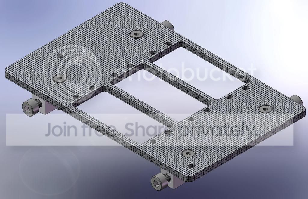

This is built with on a PlatinumRCProducts Extended chassis but will fit on the standard length chassis along with the FLM chassis's. This kit is # PRC112 and includes the CF Plate along with all hardware and cross braces that are needed. The tank is not included but it is a Hellfire 150cc Tank which is HPI# 87505.
Here is what the plate looks like which bolts the stock steering servo in the same spot. (Tank supports and Hardware is not shown in Picture but is included)

Great mod and post, have you done the OFNA mod with the other plate that Platinum sells? Will both of these work on a stock 4.6 X with the stock TVP's?? Their site says they include all hardware for instalation with the exception of the tank....what other items will I need, from a stock set up??
Everything is included in the kit's except for the tank. I have done one with the OFNA 250cc Tank but need to get it posted however it is on the FLM TVP's not our Platinumrcproduct TVP's as these kits fit both. I did this part very similar to FLM because I was running there chassis as the same time and wanted a clean mid tank set up on it and I wanted it to be universal to others.
As far as it fitting on the stock TVP's some people like AoD have done this and said it was very easy with a large washer because tords the back there is no mounting hole. I however have not done this. So to answer the question it will fit but will need some extra work. You could PM AoD he may give you a picture of how he mounted the rear of the plate.
