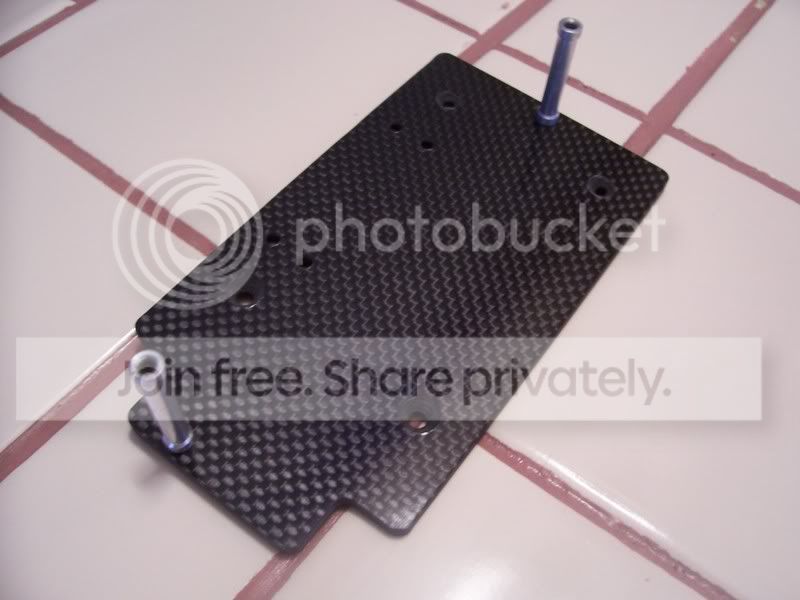

First off I would just like to state that Jason (larsenracing) from PRCP is a very professional person to deal with and the quality of the products I have received from him are top quality all the way.
I received the package within a reasonable amount of time (5 days) and they were packaged very nicely. I opened the package and was blown away by the product and how well it was machined. Very thick and well polished.
It bolted right on just like promised and I was very impressed with the way it all lined up. Recessed holes for the screw took away any worries I had of the tank rubbing on the hardware and causing me problems down the road.

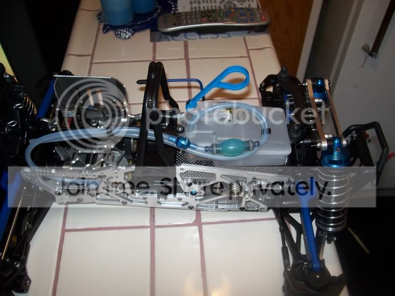

The 250cc tank (from OFNA Hyper One Seven) fit perfectly! I was so psyched to get it all hooked up and see the finished product. I have ran almost 2 gallons of fuel with the plate in there and it still looks perfect. I did seal the outside edge with CA glue since I was told chassis flex might make it crack. Hear is a pic of it all together.....
Honestly I cant think of a negative thing to say about this upgrade. The runtime is killer and the product doesnt look shabby. What more could you ask for?

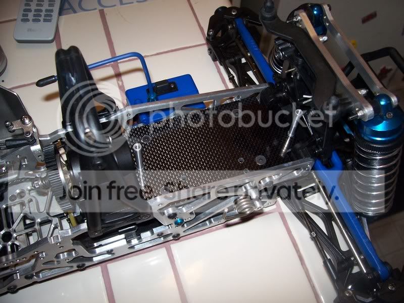

Looks good on that flm truck, I might have to give him another go, always looking for a little longer run time. What was the price? And wieght saveings?
How did you mount the st. servo?
I just mounted it to the TVPs like FLM intended with there mounts. I already had it hooked up like that before I figured out how I was going to get the tank in there. Here is a pic with the plate off.

I really am not sure what the FLM plate weighs. But this one is very light for how thick it is. If Jason doesn't know the weight I could take the plate off and weigh it for you. It wont be that hard to do.
I haven't measured that exact plate for some reason but it will be very close to 26 Grams and the FLM will be more than double that maybe 65 grams.
For instance my extended LCG TVPs are 80 Grams the stock savage X ones are 78 Grams and the FLM extended LCG TVP's are 129 Grams and mine have much thicker x-bracing to give it added strength. Anyhow just to give you a perspective on how light CF is.

How much run time are yall getting out of this tank?
I have almost everything to complete the mid tank mod but i'm just wondering what kind of runtime to expect.
I'm getting 18 minutes of runtime per tank at this point. Thats running the smaller restricter inside the carb. I was getting 15 with the larger one and with the engine still running rich.
