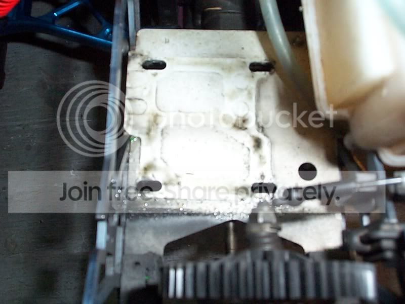

also check the engine plate and mount, mine were bent also causing it to eat spurs

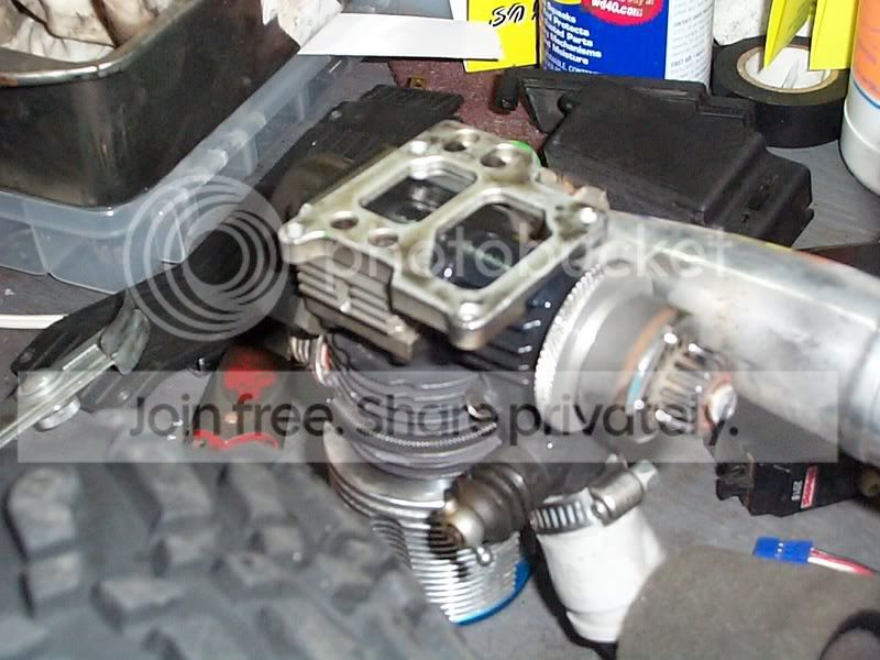

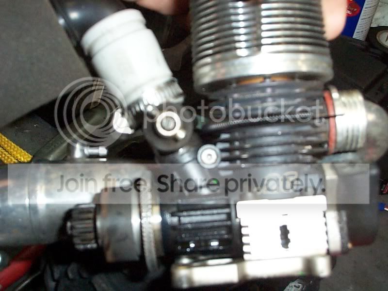

i just ripped off my cb and found out that my shoes are shredded, looks like they are stock. there is a bolt looking object that the clutch springs grab onto that i cannot remove to check the bearing for leaks, the motor looks half sealed. any help with this? the pins on the flywheel make it very difficult to remove this bolt and i don't want to strip it.
use a socket (10mm i think) its the flywheel nut gonna have to grab the flywheel with plyers or something
then u weel need a bearing puller to pull the flywheel off. you will know if it is leaking there will be oil all over the truck:
sorry for crappy pics they are 2 or 3 years old now
