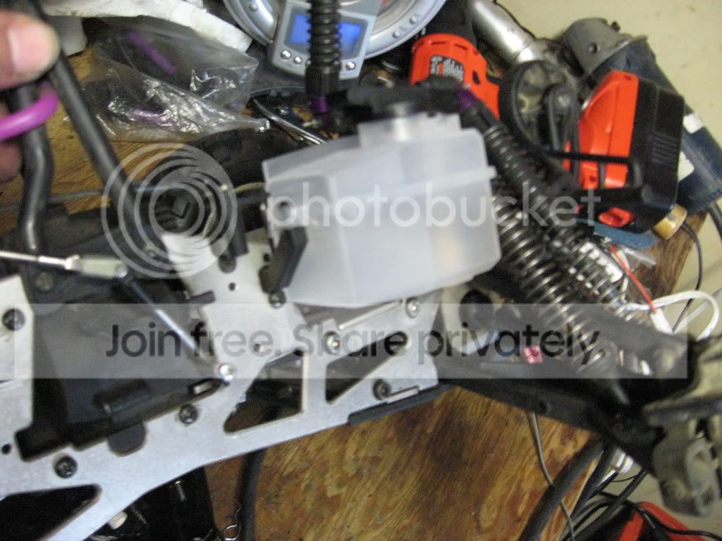

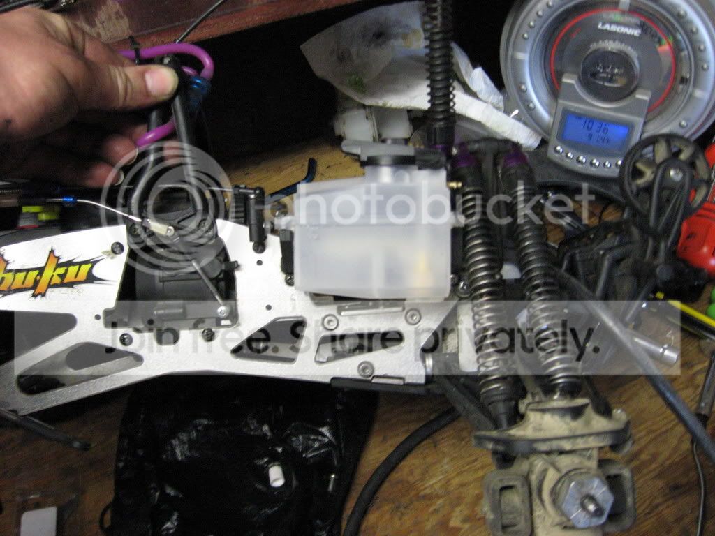

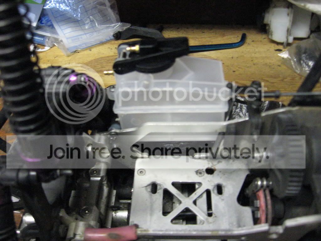

Got my ofna 125ml tank . I followed this guide to install .. Will update and tell you how it does
Moto's Printable Ofna Tank Mod Install Instructions

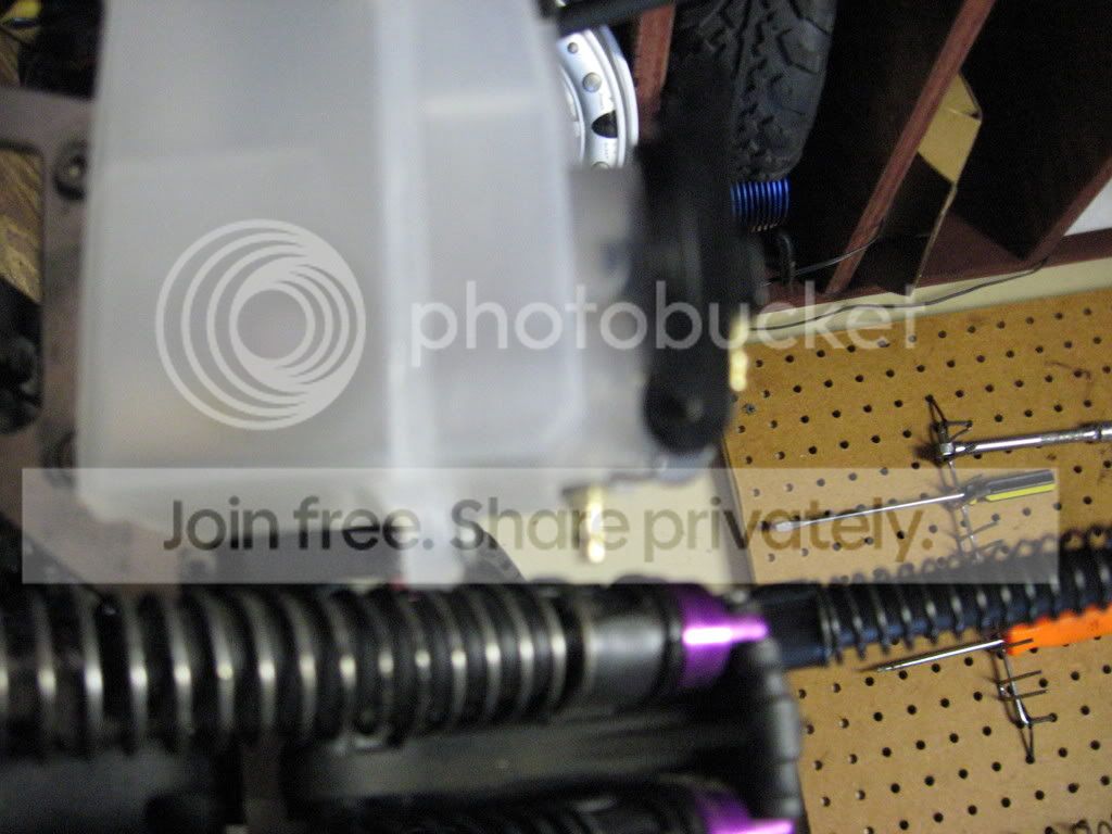

only issue I have at the moment is how close the tank mount is to the rear shock
Very good job, looks slick! I'd be worried about that shock tower as well. That's why I went with the midtank mod. :)
Either way, very good job!
Well just ran 2 tanks .. The lrp has never ran better temps 220*
NO LEAN ISSUES !!!! Its great
I will be bashing testing Sunday !
LOL SJ. It's so nice ridding that leaning problem! I kept my tuning driver in my hand for the first 5 tanks after I midtanked my X LOL!
From your pic it looks like moving your shocks to the inside hole in the towers instead of the center might clear the tank. Did you try that already?
I know you already cut the tank, but heres another way if you have a tank guard. Get two savage 21 steering posts and use them to mount to the bottom of your guard.
Awsome thank Grumpy .. I will do that .. About the shock . I was looking at that last night .. I thought the same thing I will be doing that
