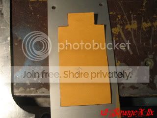

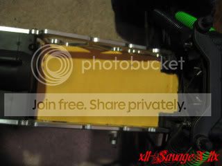

Ok guys since I'm using the OFNA 250cc fuel tank with my Mid-Tank i can't use the FLM servo plate and since i had some 2mm aluminum laying around i thought i could do some thing with it 🙂
The dremel cut of discs i have are to small so ill ask my Dad to get it CNC'd 🙂
here's some pics ::
What do you guys think ?
Thanks
- Brandon

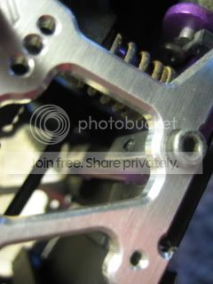

So the "M3 machine screws" are the black hexed screws that can be used on the TVP braces ??
Crap - I have not used the standard Savage screws for so long, I don't know which one to point you to - I get bulk hardware from McMaster-Carr :/

I was talking about these screws...
(The one holding the TVP brace)

So i got to my Dad's friend today in Stanyer Ontario, instead of getting it CNC's he had a % axis water jet (Alot smoother cut) and it looked really nice, we got back home i set the plate on the mounts and it was off way to much..I don't know how or why, i spent an easy 1 hour making a template and making sure all the angles where 90° and my measurement were right...So what i am asking is does any one have the measurements for the OFNA 250cc servo plate ?
Thanks
- Brandon
