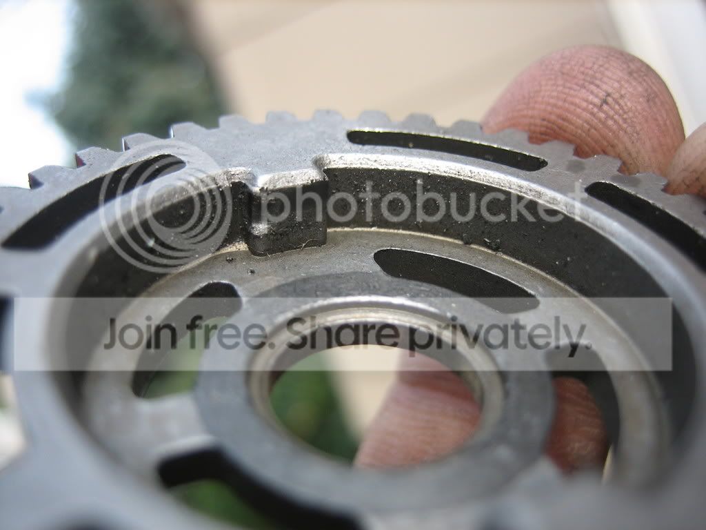

There are things in the trany that can fail. If the spring isn't good it will not work well also if it will not shift it could be (Pictured below) the cogs in the gears that are worn. This would inhibit any shifting.
