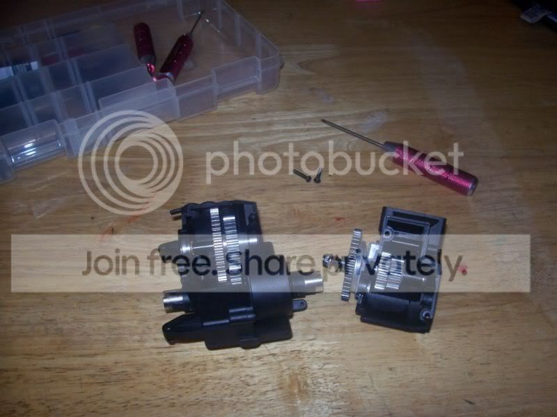

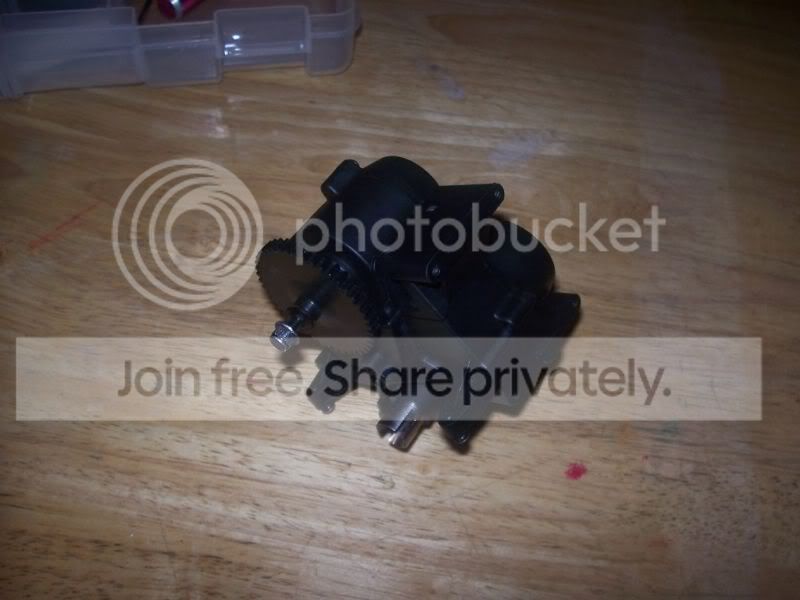

I got my FLUX transmission conversion gears today. They consist of a larger alloy idler gear that eliminates all the gears on the center cluster and an alloy 44 tooth spur gear.
The upgrade packages didn't come with any instructions but after a couple test fits I have it all installed and working properly. I guess with all this power I better use the slipper gear instead of just tightening it down all the way. So I will need to buy a new spring for the spur gear.

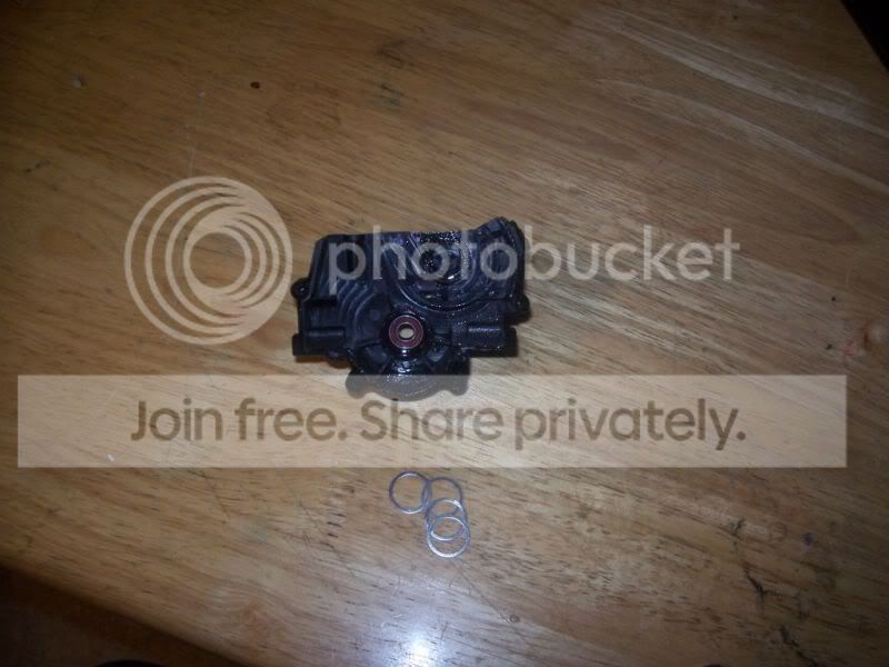

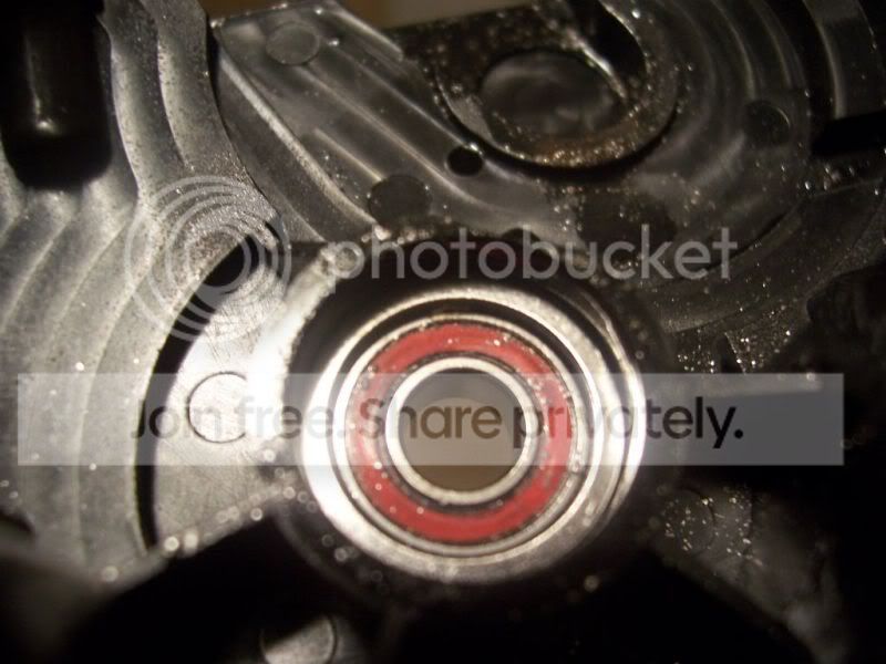

I don't know if anyone else has noticed but there is a lot of play from side to side on all the gear clusters in the transmission. I knew from my 3 speeds that it was bound to be a problem and it was.

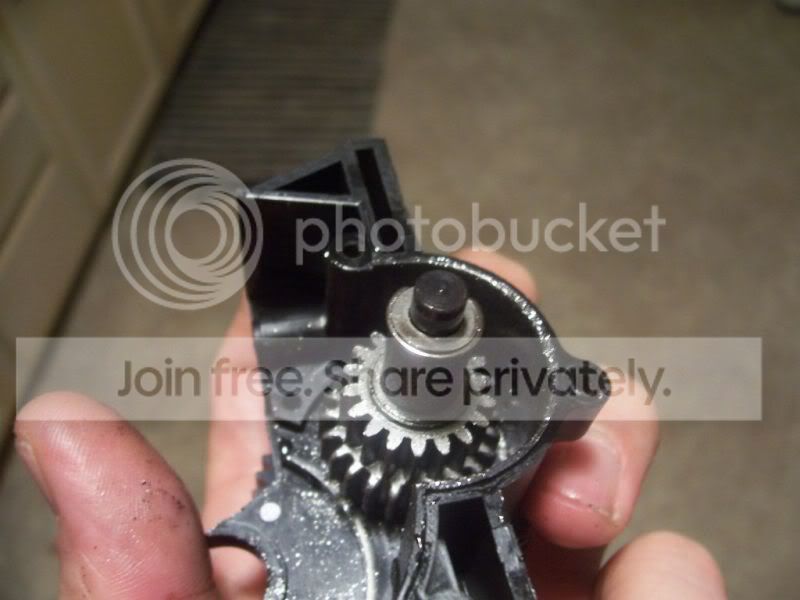

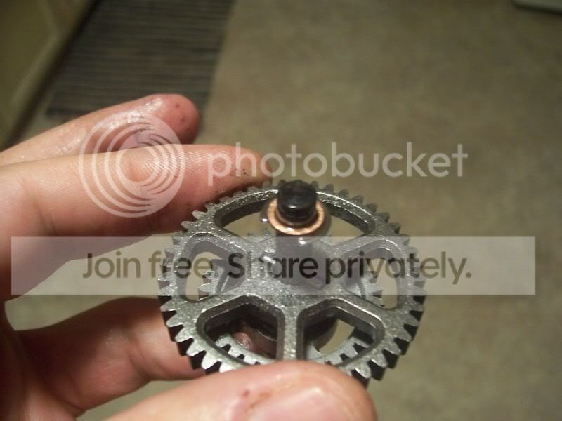

I ended up adding a couple diff shims to the outside race of one bearing and shimming the bearing out on one side of the other 2 to hold all the gears in 100% alignment with each other. When the gears were pushed in opposite directions I lost about 30% of the contact area between the bottom 2 gears. Thats quite a bit of lost surface area so I decided to fix it. Here are where I needed to add shims. And no, its just powdered graphite.
I was told on another forum that the 18-23T gear (in the last pic) is not up to the task of running in the FLUX. He recommended I get part #102514 and replace them. Any info on this?:thinking:
http://www3.towerhobbies.com/cgi-bin/wti0001p?&I=LXXSA9&P=FR
see, now thats what you get for going to another forum. i woulda recommended you the same gear but saved you almost $8.00 on it http://www.tcscrawlers.com/HPI-HD-DRIVE-GEAR-18-23-TOOTH-1M-102514-p-17468.html
Is that one necessary? Or will the original one likely last fine on 4S?
