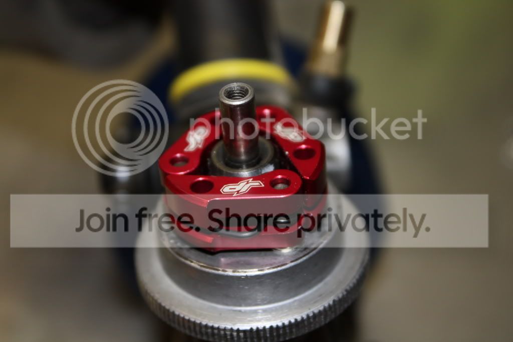

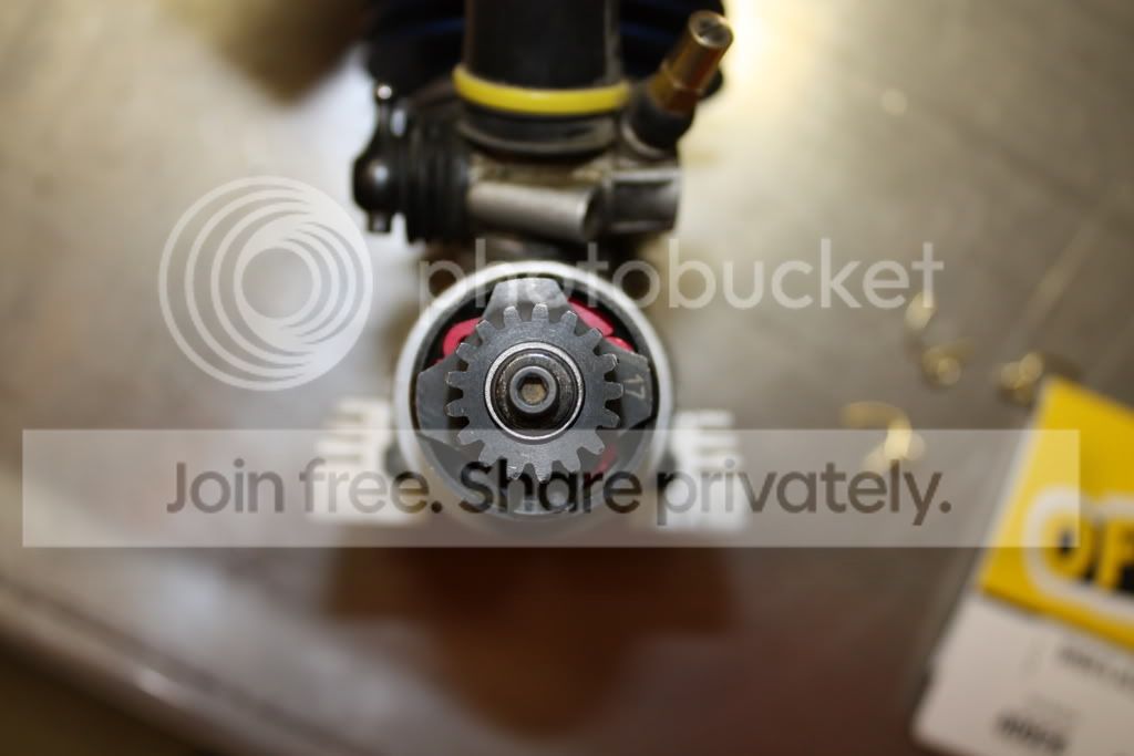

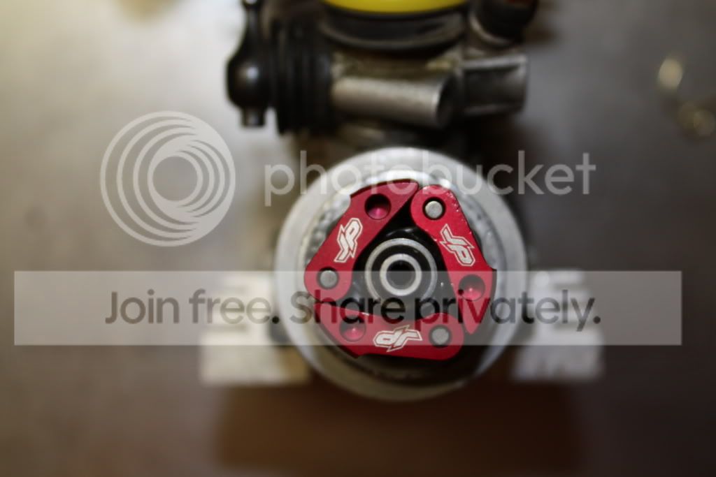

How do I know if I've put my clutch shoes on right? The clutch bell seems a bit tight fitting back on. Anyone got pics of properly done shoes?
Sure do bud, Here ya go.
You want to have a very minimal amount of front to back play on the clutchbell, it should spin freely and not bind on the shoes, if it does not spin freely shim the cb forward in small increments untill you get it right, hope this helps.
These shoes are lightened up from the Integy ones but do look very similar. I can't say how they last because I have only ran them a few times but still look brand new. The Jammin ones come with 2 sets of springs as well. They work very nicely thought.
