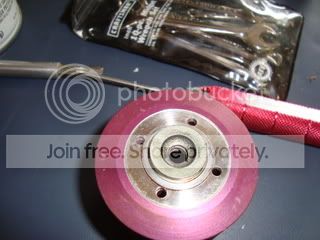

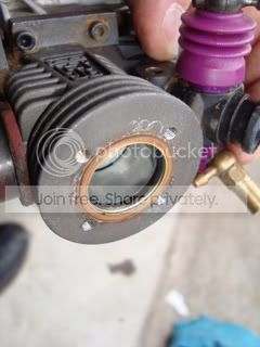

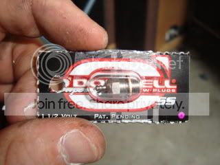

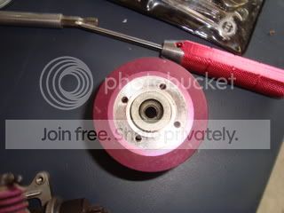

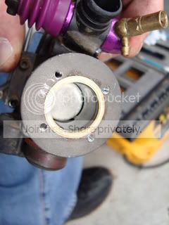

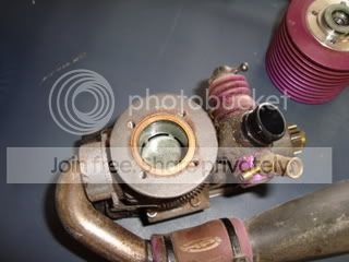

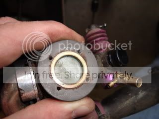

Hey everyone, I recently purchased a used Savage 25. The motor runs, but it has its issues. I haven't done anything besides an aftermarket air filter to the truck. I reset the carb settings and retuned the motor. I can run the truck through maybe 2 tanks of fuel and it fouls a plug. It has been doing this since purchase. I run the truck again yesterday and it again fouled a plug, now this past weekend I took apart a portion of the motor to see if there was anything visibly wrong with the motor or if there were some signs of what it could be. Here are the pics before I cleaned it and the brand of plug I am running.
Anyone have any thoughts of why it is fouling plugs?

You need a colder plug imo. I'm in Texas too and I run McCoys MC8 or MC9 (cold/med plugs) with 30 percent nitro. I think Oddonels cold plug is the #99 (but don't quote me on that one!) It also sounds like your running it too lean, how much smoke you have while running? Never tune to temp! Tune to smoke and sound! Temp guns are a good safe guard but are radicly misleading to what the real temp is--straight from purenitro himself. You can get several temp guns and use them all and each one will have a different reading on them...anywhere from 10-50 degrees off from each other. Tune to smoke and sound...temp is only safe gaurd a small safe guard and not to be used as the way to tune.

It usually means you're running lean. In those pictures you posted it does look like the piston is getting black, so that may be the case.

Hey everyone, good news!!! I picked up a colder plug yesterday and my savage is running better than I have seen so far. I need to do some more small adjustments to finish dialing it in but its running really good!! I'm gonna try tightening up the spur gear a little more and hopefully that will get me to popping wheelies...I hope. Thanks for your help from everyone that chimed in!!
