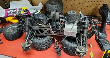

Wanted to start a new thread on my new to me Savage.
A friend gave this truck to me for basically free.
It was beaten and neglected, and sitting for years. And filthy.
My first HPI! I've owned many RCs, I have about ten electrics currently but this is my only nitro at the moment.
I've owned one other nitro but never really got into it so I'm gonna need tuning advice when the time comes.
I'm mostly done now and took some pics along the way.
The first thing I did was pull the shocks.
The dual-stage shocks seem pointless to me on a basher.
The little collar divider thing between the springs rubs on the shock bodies and scratches them all up.
Shock upgrade is gonna be in the future.
I found by flipping the springs so the collars are on the bottom (short spring on bottom) it frees up the movement. Hopefully the springs stay on haha.
Noticed the shock shafts were bent so I replaced those.
More interesting is that the springs are also bent up. If this wasn't a basher theyd be replaced for sure.
Did the V2 17mm hub and super HD axle conversion
Next I picked up some alum hubs, didn't love the plastic
Had a set of 17mm hubs laying around so I use those and drilled out the 2.5mm hole for a standard 3.0mm pin
Boggles my mind that HPI uses a smaller axle pin on this heavy trucks.
Also I'll be running the huge tires seen in the first pic background.
