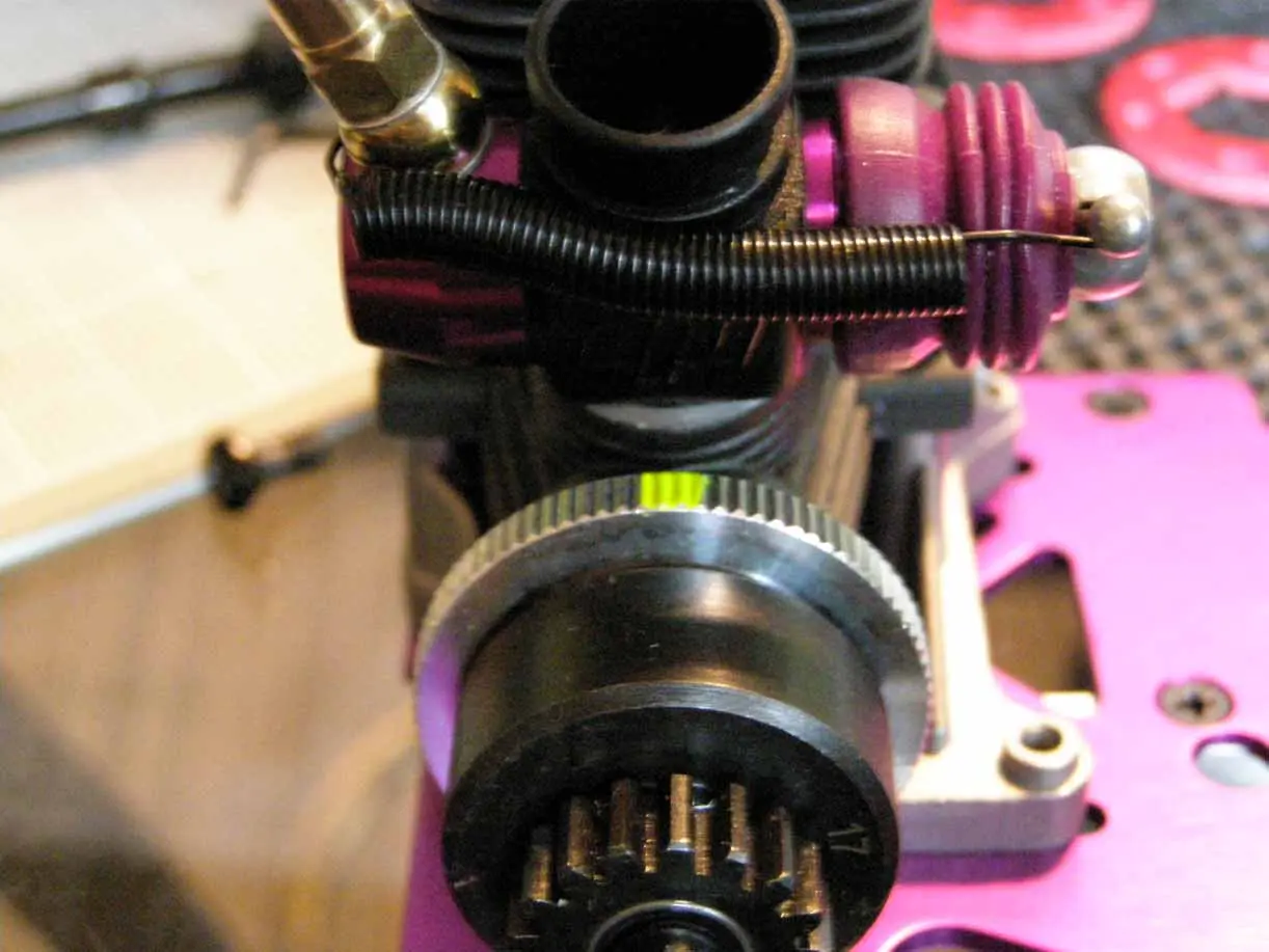

BDC means Bottom Dead Center. This is when you roll the crank until the piston is at the very bottom of the crank case. Before you install your new engine look at the piston through the exhaust and when the piston is at the bottom put a mark on the flywheel. This will make it easy to set the piston to BDC.
Once you locate BDC, or Bottom Dead Center, put a mark on the top of the flywheel to indicate where it is.
EVERY time you shut down the engine, turn the flywheel to the BDC position. Once you have that point marked it's effortless to just turn the flywheel and know that the piston is exactly where it should be as shown in the photo below.
bdc-jpg.15440
