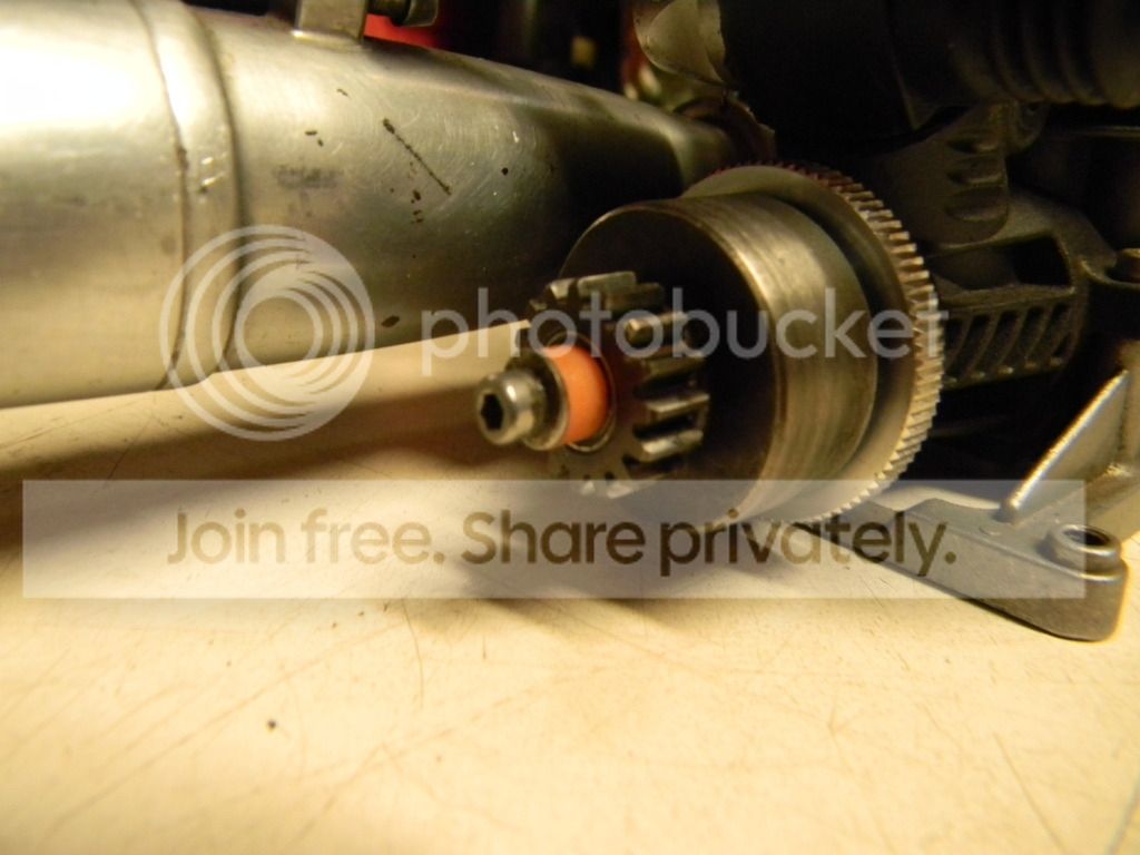

Left is new right is damaged. One side of washer faces a bearing, the other is the screw to hold it all on.

I think you need a different screw. Small head did this. Or try and add a washer.
OFNA made a clutchbell shim kit, lot better than these brass washers. I didn't even know they still existed. 🙂 🙂 Last time I used them was over 8 years ago iirc.
I would replace that bushing with a bearing. And match the screw head/ washer holding it in to the inner race of the bearing.
