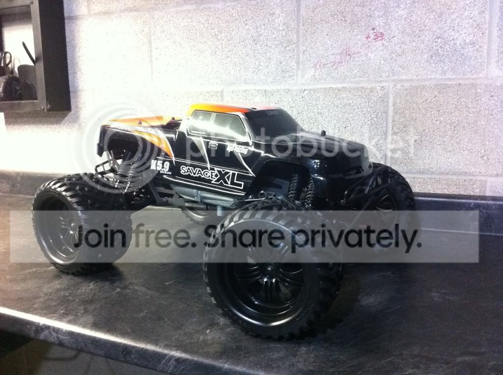

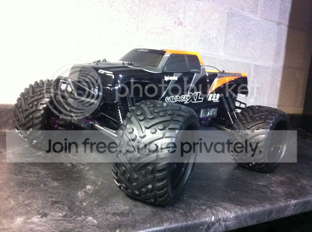

I cleaned up the goliaths and tremors
This was with the 6+1 irc chassis I wanted the look of the XL so I switched my build. I was looking into the flm XL HD tvp's but never heard anything on them
