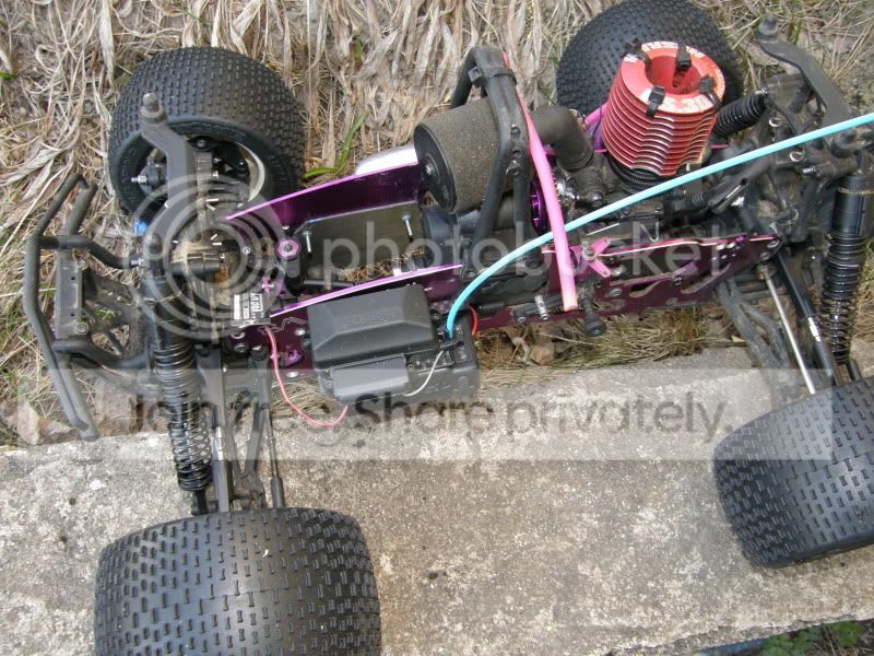

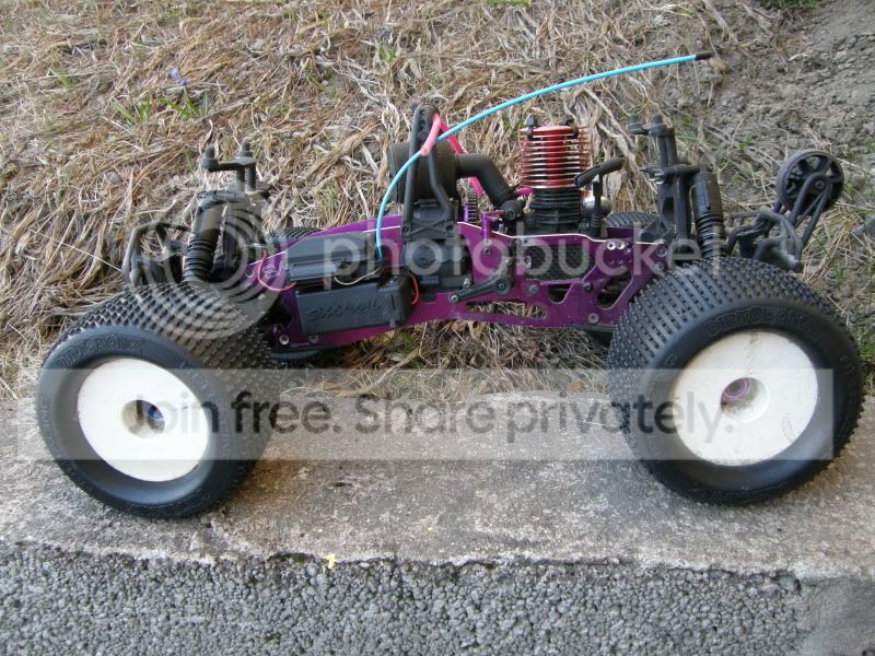

I started to modify my X to make it run better.

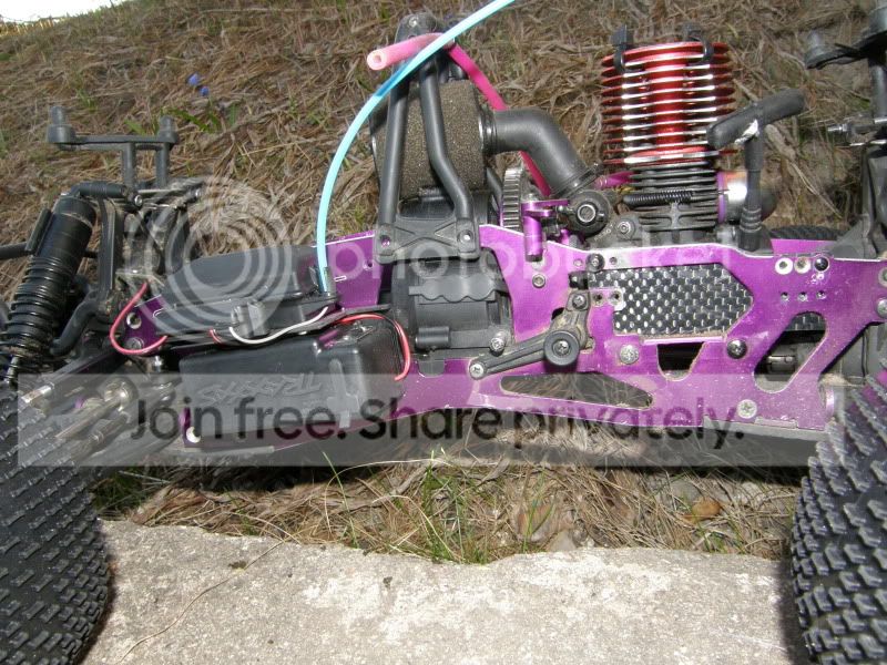

I ordered 250cc tank, ofna throttle links, traxxas watersealed battery box and receiver box, bearings for steering, savox servos.
I also started to make my own fiberglass body.
Hope you like.
Some pictures..

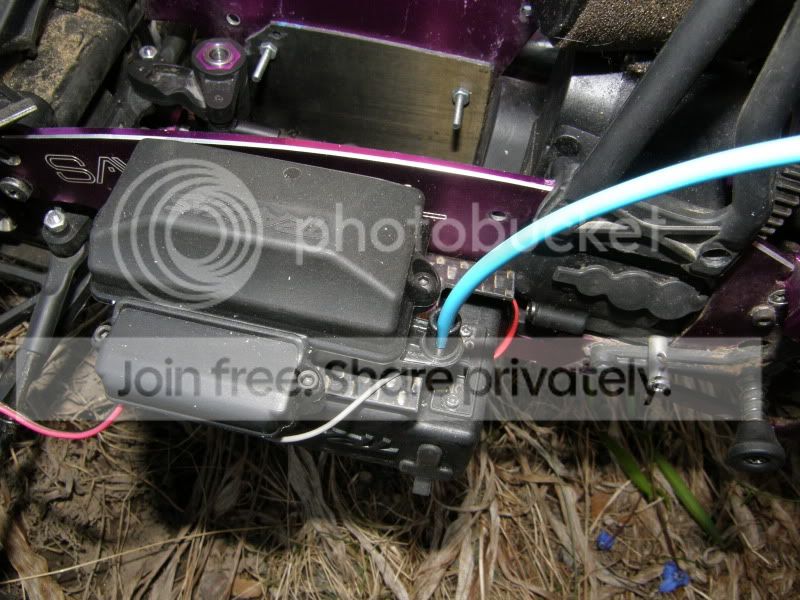

Battery/receiver box:

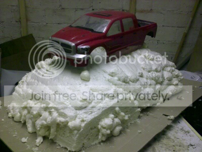

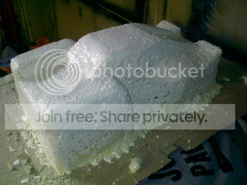

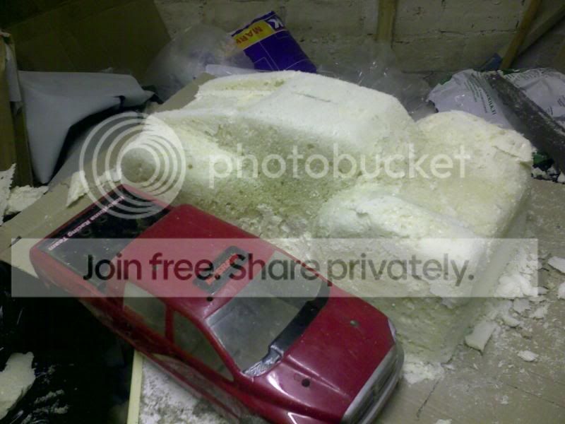

Body:

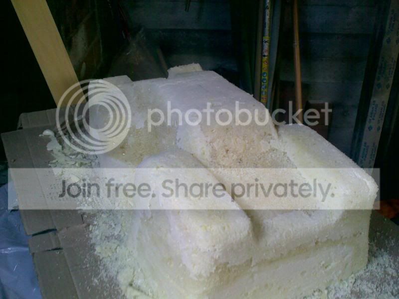

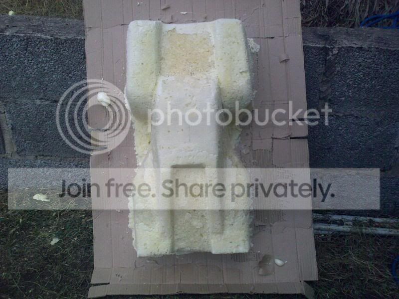

Yes. It's poly urethane foam.
Never goin to do with that foam again..
Takes long time to dry and there is lot of holes inside.
Next time i'll try some other material.

I am not ambitious as you, but just a idea... Next time get a 4 x 8 sheet of 2-4 inch poly cut and bond the sheet to make the starting block. Not cheap stuff but a better platform to work with. Good and dense. I used it as brick shelf and stuff forming concrete foundations for coustom homes.

Battery Box T-Maxx, part number: TRA4925
Traxxas Sealed Receiver Box: Slash,E-Revo, part number: TRA5624

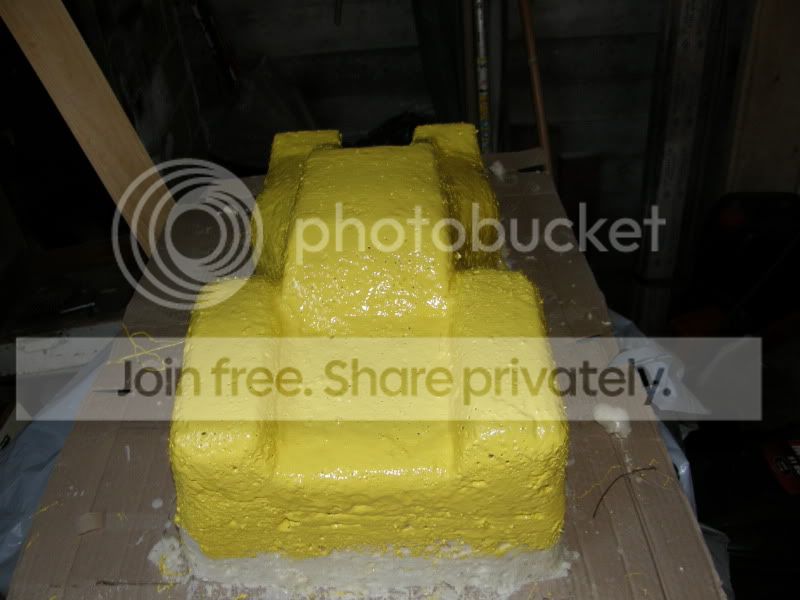

first gelcoat layer:
Couple layers more and it should be good enough to make mould.
Then some hard wax, gelcoat and fiberglass..🙂
