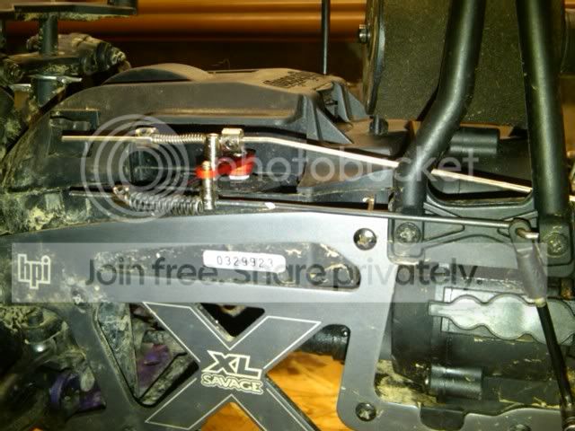

well for the servo issue i am going to upgrade the steering servo to the HPI SF-32TT becuase it has 330 oz-in of torque, and then take my stock steering servo and use it as my throttle/brake servo. that way they will both have metal gears. hopefully that will be the last time i gotta mess with servos.
well I had a servo laying around from one of my traxxas trucks.
#2070 which has 125 oz-in compared to the HPI #SF-10 which has 62 oz-in.
