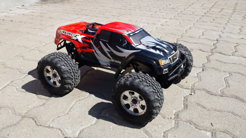

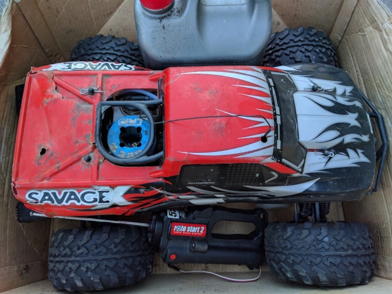

I bought HPI Savage X for 75€. I knew it needed some work, and for that money it shouldn't be problem. From factory it came as X 4.1, but now it has LRP Z28R in it, which still has little bit of metal pinch in it. It has been sitting for 3 years in garage, before I bought it. I've already done complete teardown and rebuild, but I still have some stuff left to do. This picture below is how it came when i got it.
And this is what it looked like yesterday, when I ran it for first time.

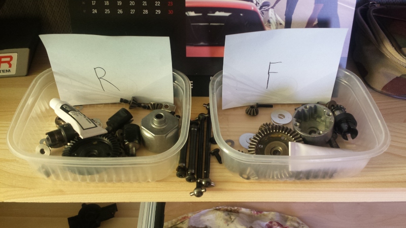

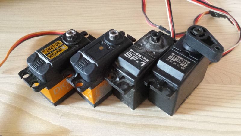

What I've done now: Replaced all ball bearings, new Savox servos (1267 for throttle/brake and 2274 for steering) + new aluminum diff cups with new spider gears (One diff was toast inside when I got it).

I'm not going to use any voltage regulator, because I want to get most out of those Savox servos. They are built to handle 2s LiPo, I use same servos in my TLR nitro and ebuggy. Savage will be only basher, but i kinda think that sway bars stick that truck better to the ground and make it more stable in corners. But i wont order any stuff soon, because other cars need care too.
