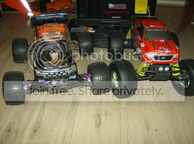

Here are the parts il be using.
Il be using:
My K4.6 engine, has just shy of a gallon of byrons on it, its still fairly tight from new! Il be fitting the new roto-start backplate i bought with the engine but never used, he has a rotostarter already and his son is used to starting with it, a pullstart would be too much for him.
The stock plastic clutch is shot, so il be putting my used but still decent nova shoes in and 17t HPI vented bell + new CB bearings, shimmed.
My old X air filter with new foams
HPI polished pipe, iv just bought a new one for my truck so my old ones going on.
My old X bulks which are as good as new, a couple of used X towers and my old upper pin braces, il be drilling out my 6mm hex bulkheads to accept the 25's round 7mm joint posts coz i don't have any of the X ones spare, i now use flux bulks and the RSC so these are all parts il probably never use again anyway.
My old X TVP's, i gave these to him a while ago but he never got round to fitting them, so theyre going on.

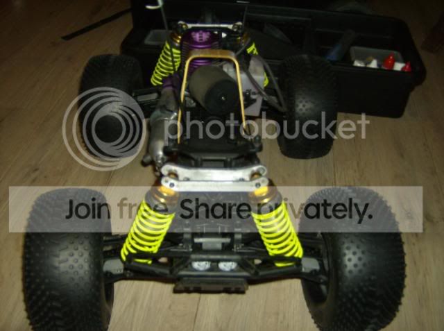

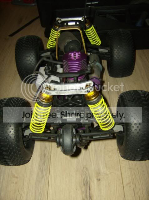

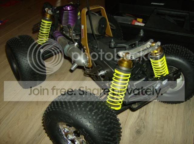

Four of the shocks that are on the truck already are four of my old stock shocks and the four i have left are bent too so i have nothing to replace his two front bent shocks so................. my LST's are going on!! with the I-RC kit and my integy HD rear carriers! He fell in love with the LST's when he saw them on my truck and i know he reeeeeaaaly wants them so WTH i got my big bores now so theyre his!
Il strip the truck down, clean everything, strip down clean and refill the diffs with 30.000wt silicon fluid, they must be bone dry by now, replace the tank with my old stock tank that i know doesnt leak, replace fuel lines, then rebuild using all the above parts.
My I-RC LST kit is for X arms so i just ordered a new set of arms for my truck and il put the old X arms from my truck on so i can fit the kit.
As i say this is no majorly exciting build, just helping my friend out getting his truck running again and updated a bit.
Il take more pics as i go along. 😀Jjam:

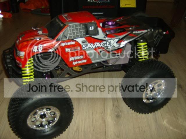

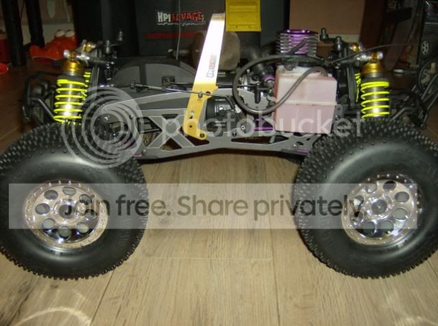

Here she is now.
Found the cause of the spur problems, cracked engine plate and all plate and cross member screws were loose.
Replaced the enigine plate, stripped down, cleaned, shimmed and filled the diffs, they are 2 bevel, plastic cupped diffs so he'l need to do them asap.
Replaced the 2 left hand thread axles with 2 right hand thread axles, one of the rear wheel hexes are stripped, so iv ordered him a set of new stock XL wheels/tyres from the bay, and i have some spare 17mm hexes and X nuts to go on.

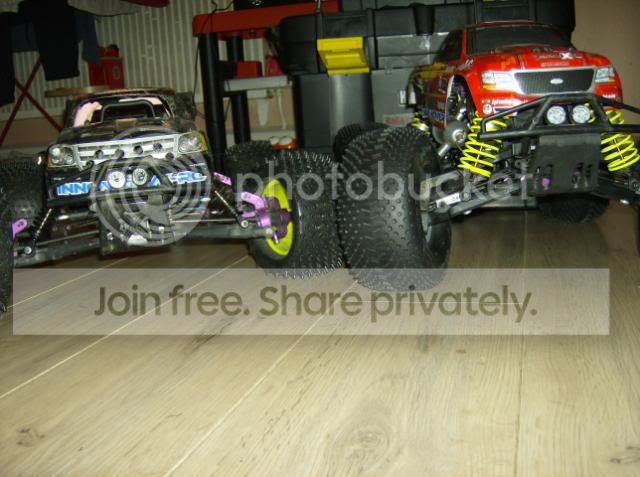

Been waiting for ages for the new X lower arms so i can fit the bottom mounts for the I-RC kit and hand the truck back over to him, the arms arrived about an hour ago, just fitting them as i type, il snap a few more pics before i give it back.
Thanks fella's.

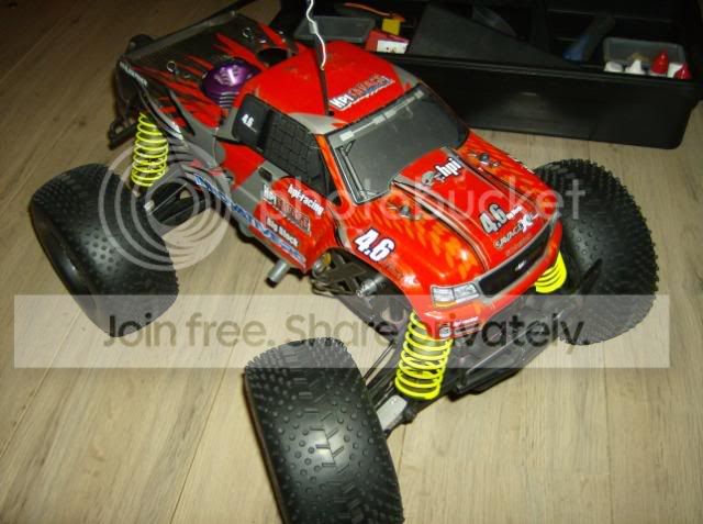

Shes all finished now, carefully peeled the remaining still whole decals from my now battered and wrecked original X shell and restuck them on and of course a few HPISF stickers!! brand new X lower arms now fitted.
Now the culprit of the spur problems has been found i threw on a 47t HPI steel spur to go with the 17t HPI vented CB
Also put new engine mount screws through the new plate and fitted washers under all the heads hopefully to prevent the plate cracking again.
