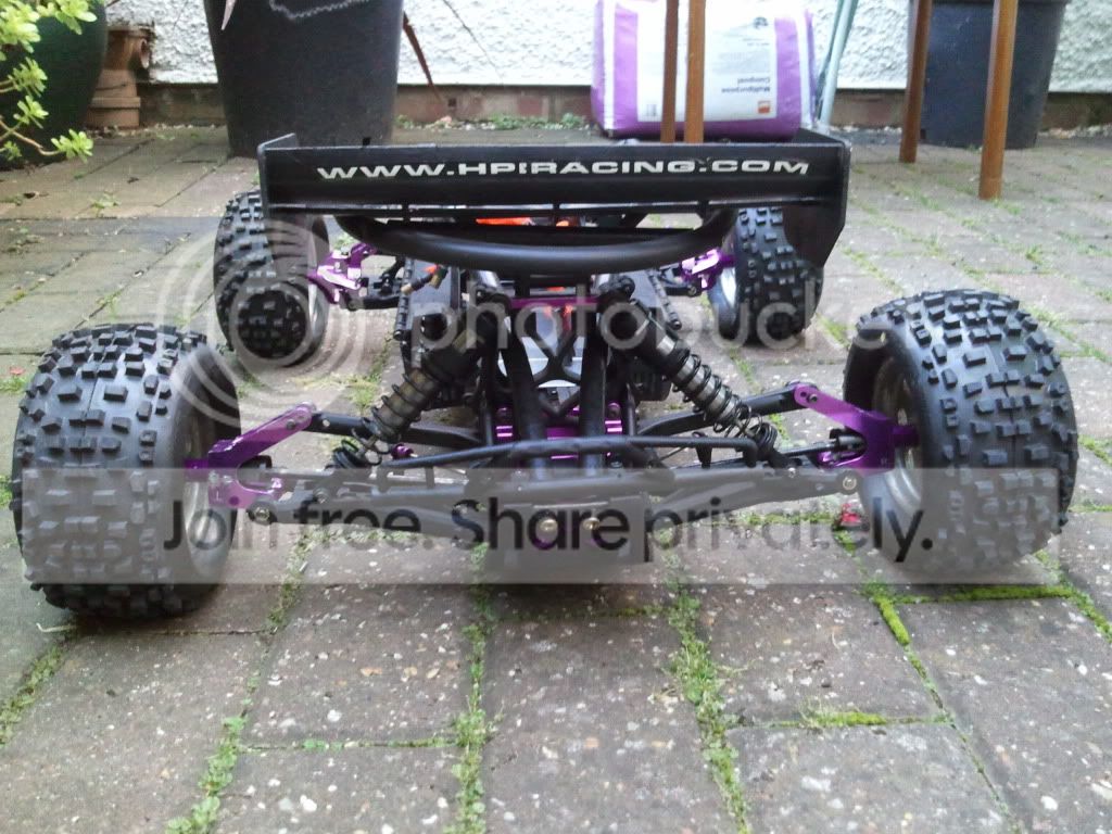

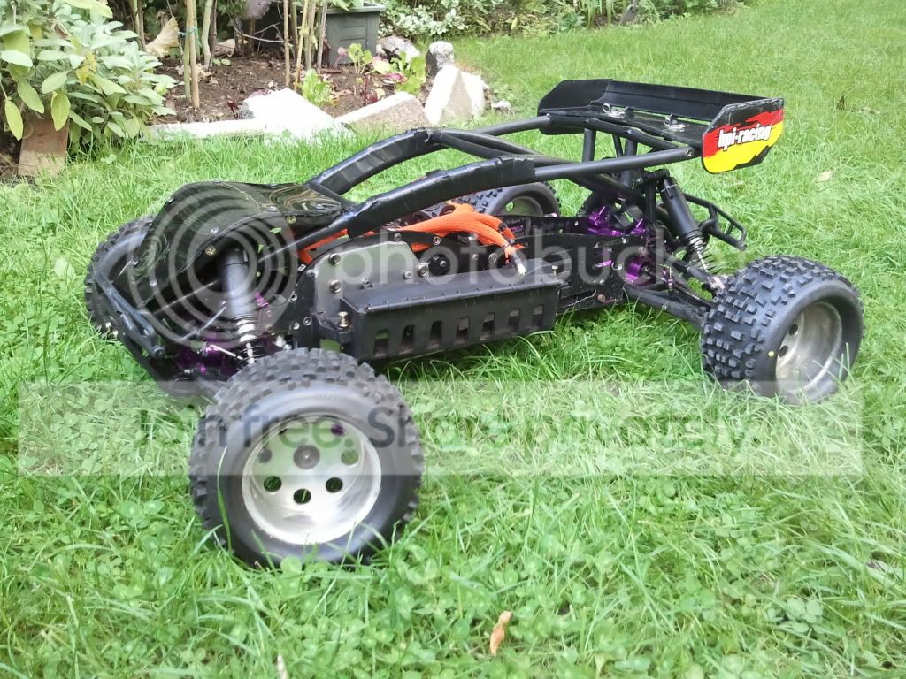

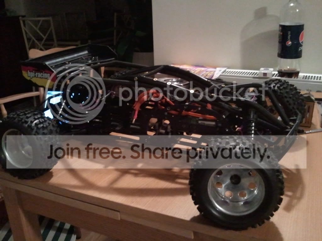

My Custom nylon - mainst nylon style roll cage.
J1A1H
967
Its still a work in progress... more info on how it was made in my build (check sig)
i removed the pre load spacers when i was working on the truck... I hadnt installed them for the pictures...
i will weigh the truck again as i am interested to see how the removal of the tranny but addition of the GH Bulks and LiPo boxes have added to the weight...
looks sweeet!!! thanks for sharing...........
Thanks a lot guys!

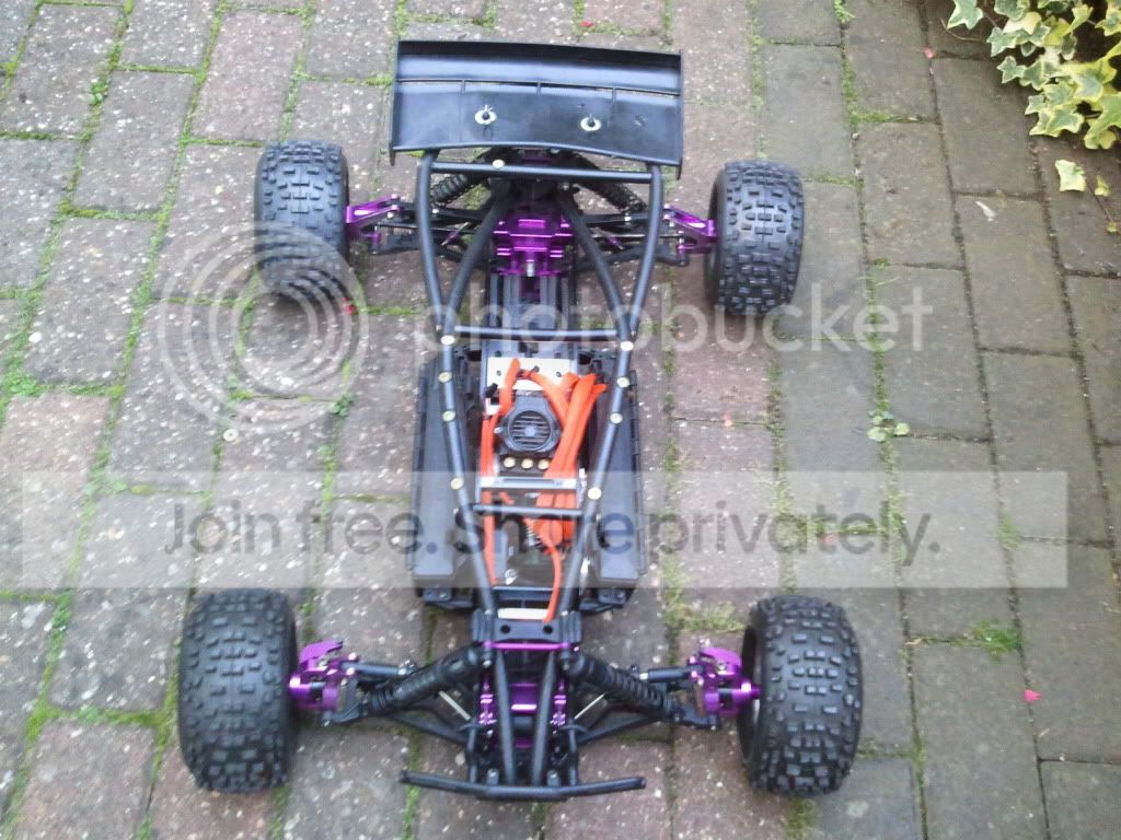

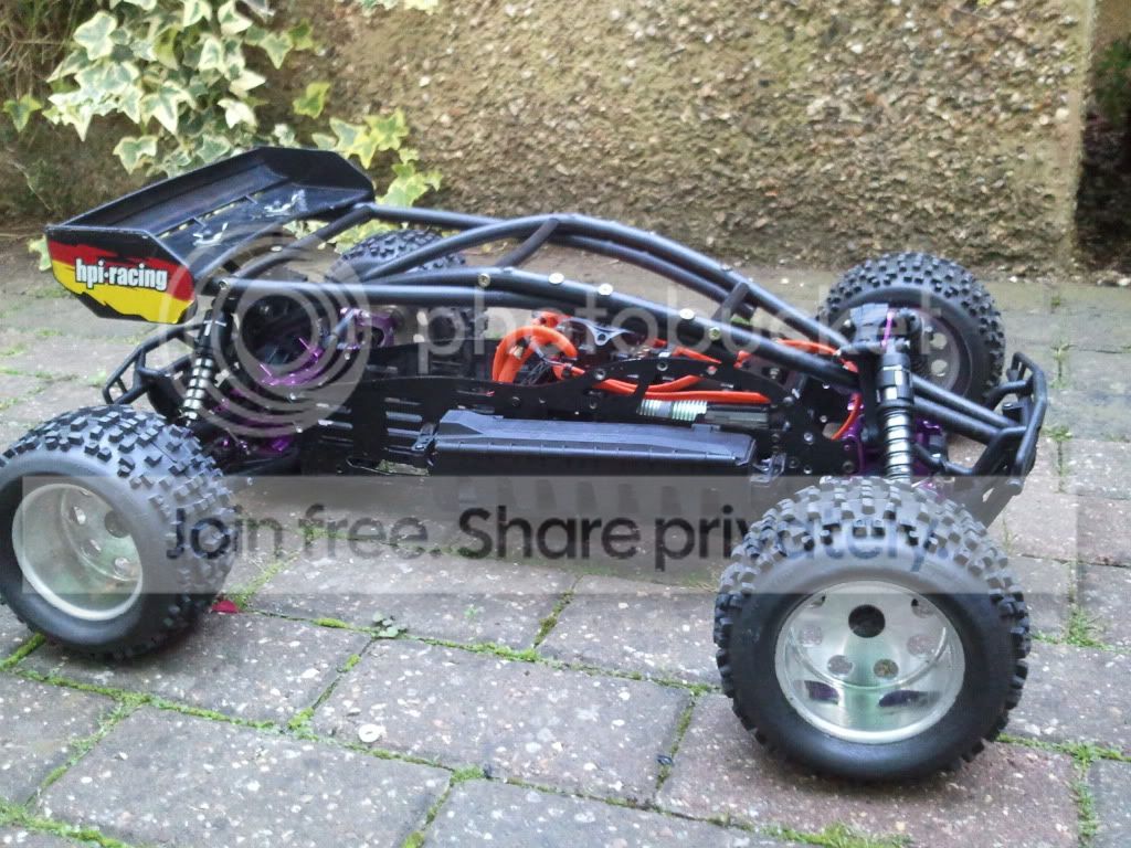

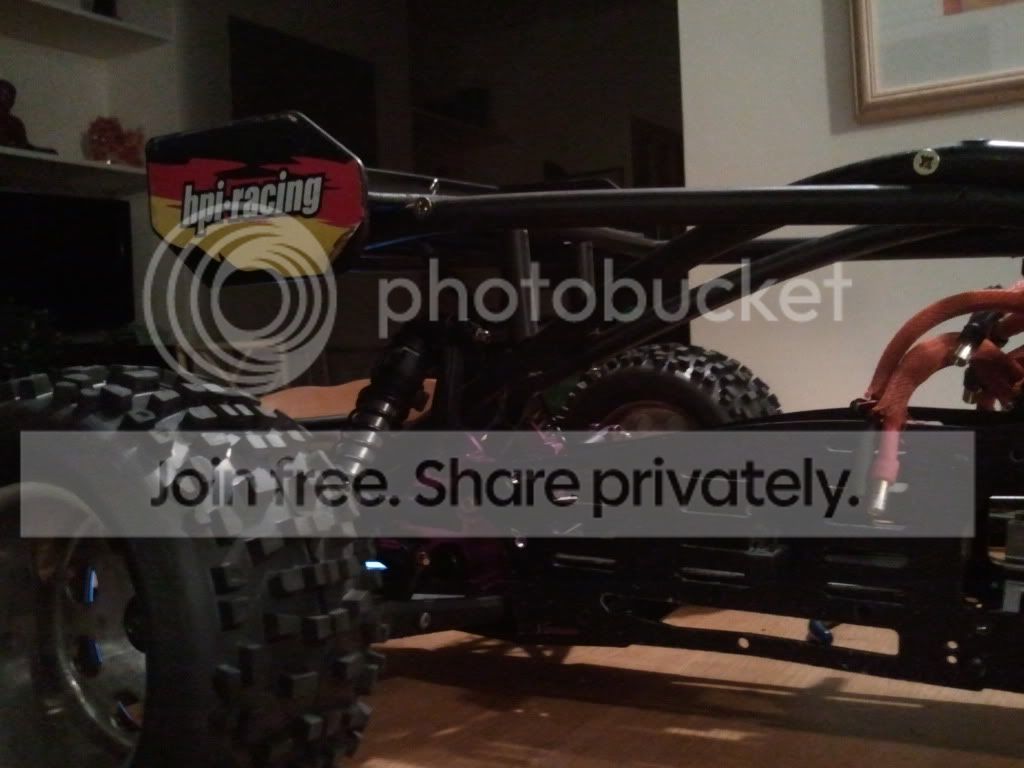

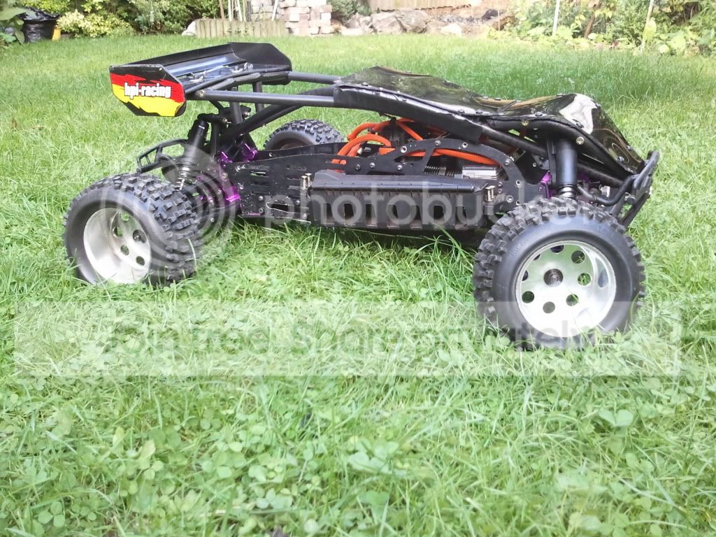

small update to the cage...
still not completed but it is very strong now whlist maintaining a lot of flex... I can now put all my body weight on it...
These are the rear supports. They are very strong but offer a lot of flex to a point
The cage isnt finished yet... should be done in the next few days...

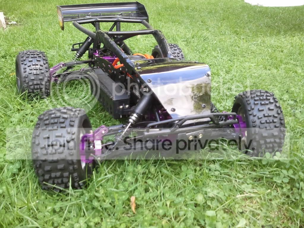

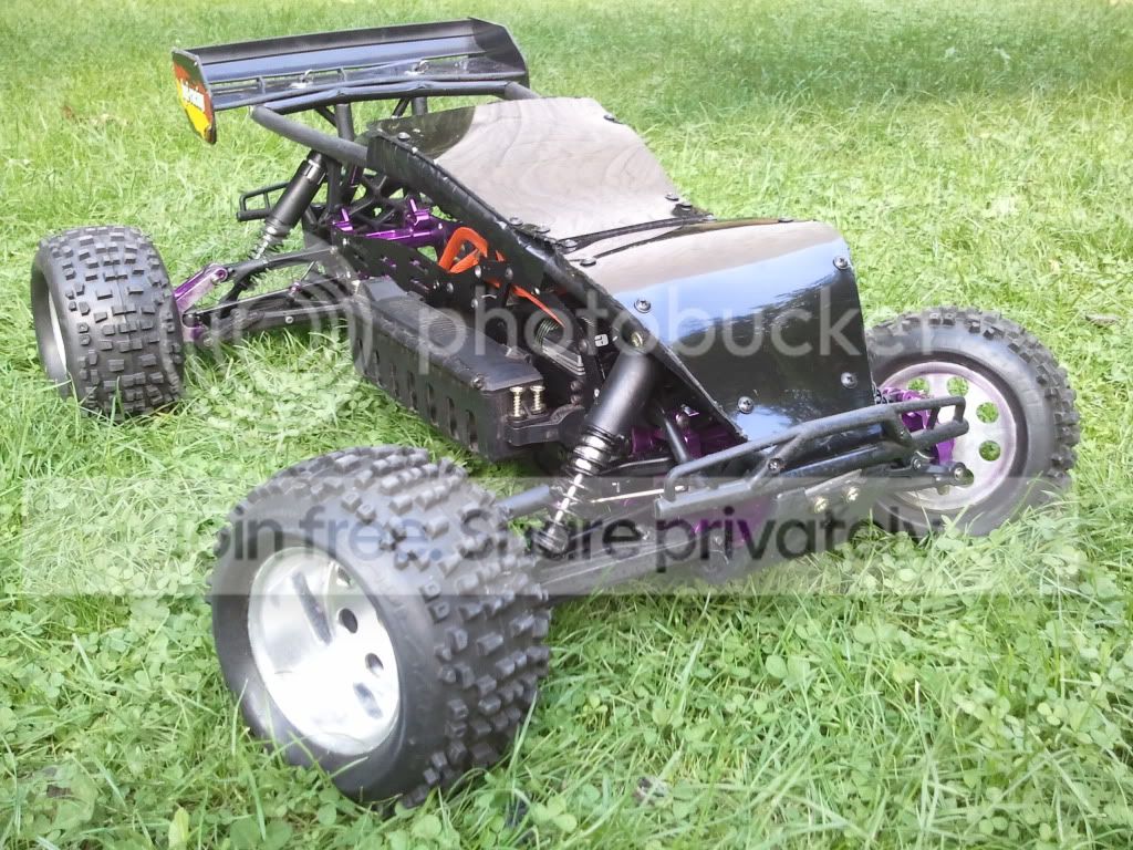

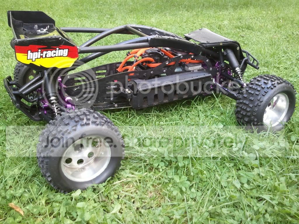

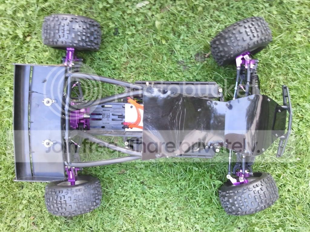

Cage Update...
I have spent enough time on the cage now and the final part didnt come out how i would have hoped for...
i thought the cage would have looked better with the nylon sheeting.....
I bought some 2mm nylon sheeting and this stuff is very strong, flexible stuff!!!
i'll let the pics do the talking....
as you can see the cage does not look great at all!!! and it just obscures my ease of accessing the internals of the truck...
so i thought i would remove the large centre cover part, and leave the front shock tower cover on to protect and offer some form of aerodynamic down force at high speeds (if it works)....
I would prefer to run the cage as is but the front shock tower support should offer some form of protection...
Plus i spent quite a bit of time on it, and so i don't want to remove all my wasted work....
I am going to make some rear A arm deflector things out of the nylon, should be robust and protect the rear a little...

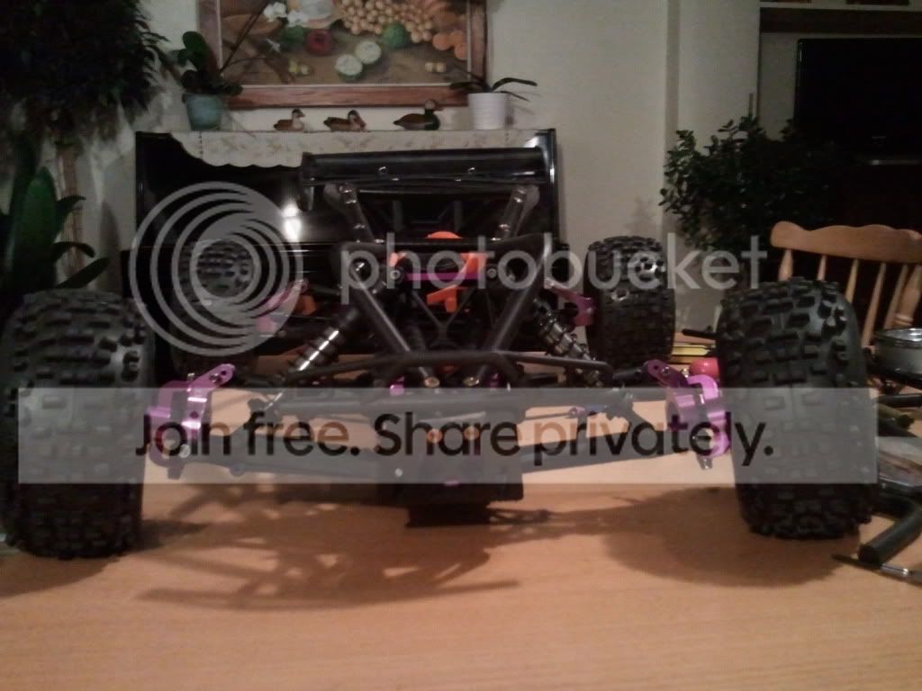

whats going on with those shock spacers? have you run em set up like that yet?
frddy, firstly I'm running the red hellfire springs (stiffest) and without running these spacers when the truck has the lowered suspension, the truck bottoms out very very easily with the weight of the GH Bulks, and huge hyperion lipos etc....
It handles really nicely when on dirt, grass, etc.. (nothing too bumpy)
When off road, i just put the stock shocks with stock travel....
This stiff suspension setup allows me to drift,and allows the car to turn nicely.
Yea the spacers work well... i wasnt a fan of the progressive spring setup...
