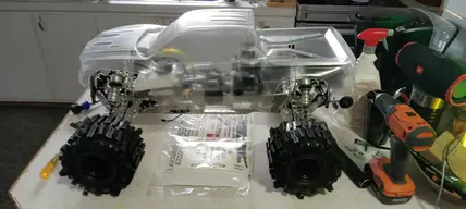

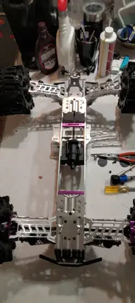

Savage XXL Twin with Twin Picco Boost .28"s exausht will be twin ercm pipes using high voltage servo flm parts having custom made alum 2.6 diameter wheels made at moment with 17mm hex and 1 1/2 back spacing 4" wide wheels to accommodate clodbuster monster mudslingers from rc4wd for the moment i stuffed JConcepts 2.6x3.2 wheels in them just so i can roll it around as i make progress on it body is a proline 1/5 chevy silverado that fits absolutely perfect with the wheel wells also ordered a full rollcage that i plan on legthening since the xxl kit is a total of 2 1/2 inch longer than the standard xl i started with i wasnt aware at first i was going to need a second servo and i already had a 1200oz steering servo so i purchased another one to maatch i know overkill lol still waiting on many paarts to move forward and this truck is all billet and cnc alum no plastic anywhere hit me up with any questions u might have thanks for looking ☺️

Awesome. Don't hurt your back lifting that monster.
I think some of my single engined trucks are heavier than this one yes it's huge but not heavy I like to keep the weight down if I can I'll do a weigh in when I'm close to being done with it

Making progress slowly but getting little by little done I mainly wait painstakingly for each part I need to arrive via USPS is what takes so long had a scare from a bad vendor on eBay tried to rip me off making my custom wheels thank God I paid with goods and services using PayPal otherwise I would of never seen my money again 2 months of waiting all for nothing so this time I found a wheel that will meet my needs from treal rc monster truck wheels cnc aluminum have been ordered and just waiting on them to arrive soon as I make some more visual progress I will update the. Pics thanks for the support everyone 😃
It'll be quite awhile before that happens still have to send the engines. In for some EBIS break-in and then run in I've narrowed it down between two solid engine modders I know well brand new Picco boost 5 port .28"s don't come along often or at all anymore so I want them close to perfect as I can get them and still have to email Robin fothergill about some ercm pipes and I heard he himself wasnt doing to good from a car accident but I'm planning to be done up and running by next spring/summer is my goal i live in NW Washington state and nitros don't run good in the colder weather so we just put them away til next season anyways 😊
