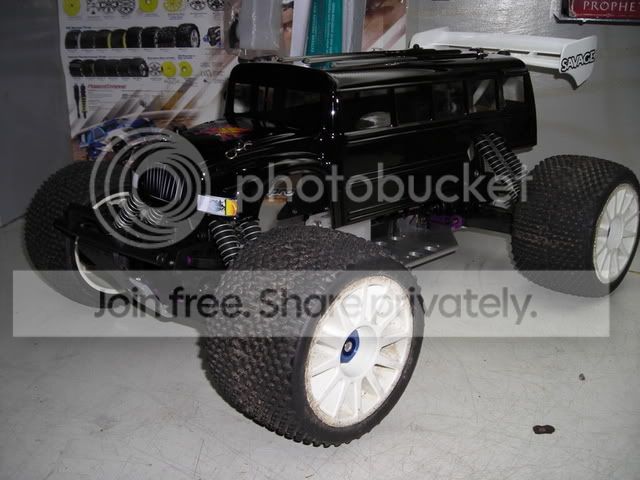

I'm done!! I think anyways. Here are some pics. They are fomr my camera phone cause my digital camera recently took a dump on me.
My first inline throttle setup. I don't know if I'm happy with it. I will proably change it up and make it look a lil cleaner soon. I gotta see how it works first. Any tips/comments would help for it.
Looks good. I see that you might run into the same problem I did with your brake linkage setup. Do your brakes engage when you go WOT? By the looks of your setup it might. I can help you out if thats the case.
actually, i was going to suggest losing the "bend" where your brake rod connects to the brake arm, as when moving back and forth, that set-up may very likely work it's way completely out...I would suggest putting another rod stopper on the other side of it, on a straight linkage rod...
I don't think so...but I will check it out. I haven't broekn in the motor yet.
Yeah I'm gonna pick up some more stoppers and stuff this weekend. I am not happy with the linkage that geos to theconnects on the post to move the carb. Thats something I do want to shange.
Its easiest to check it the brakes are going to go on when the truck is not running. Turn the truck and the radio on and hold WOT on the radio and try and push the truck. I had to lengthen the brake linkage and allow it to slide free when you hit the throttle because the brakes engage weather you push or pull the arm. Here is what I did and it works great.
