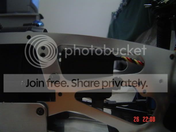

Well I got my tank in the other day, it is a 125cc MBX ProSpec tank. It took a little fitting and creative thinking to get it to fit the way I wanted it to. It slightly rubs on the steering linkage but nothing to hurt it. I used a piece of plastic I got that looks like diamond plating for my mount. I just need to get boxes for my battery and RX. I even tilted it back a little bit so I get all the fuel out of the tank. I had to notch out the cross brace where the reverse part of the tranny is. It isn't really screwed in to anything in the back but it is not going to move!
http://i82.photobucket.com/albums/j262/aj5601/Mid Tank/Midtank004.jpg
http://i82.photobucket.com/albums/j262/aj5601/Mid Tank/Midtank002.jpg
http://i82.photobucket.com/albums/j262/aj5601/Mid Tank/Midtank001.jpg
yeh nice, it looks like u put alot of time into lining everything up :p, my steering servo is on a slight angle lol... but it doesnt matter...
my mid tank is also nearly finished just waiting for my last part, ofna linkage kit :p...
