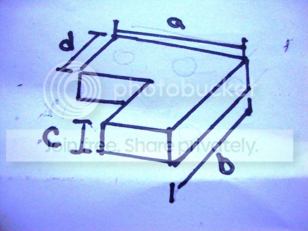

No for my next big idea to fabricate some servo mounts like the flm ones. Would this work? As I really don't want 2 pay 13$ postage on 4 little bits whihc weigh no more than 200g.
This is my idea
Sorry for the bad drawing but you get the rough idea of the shape
Now please could some one tell me the diementions of the flm ones base on the diagram listing them as per the letters please. Also what size screws are needed including the length. If some could do that for me I would be very great full.
So what do you think of my plans or am I being a total 'crack pot'. Any suggestions welcome

i built my own servo mounts for my mid tank.
a= width of servo
b= width of servo
c= i used 3mm
d= whatever you feel looks right
screw size was i believe 2mm but i might be wrong. its the same size as the bolt that holds the top of the shock on at 10 mm long. i tapped the holes in my servo mount so the screws threaded into them.

Thanks for the measurement think i will go with 5mm thickness so I can get my 5mm tap down it.
