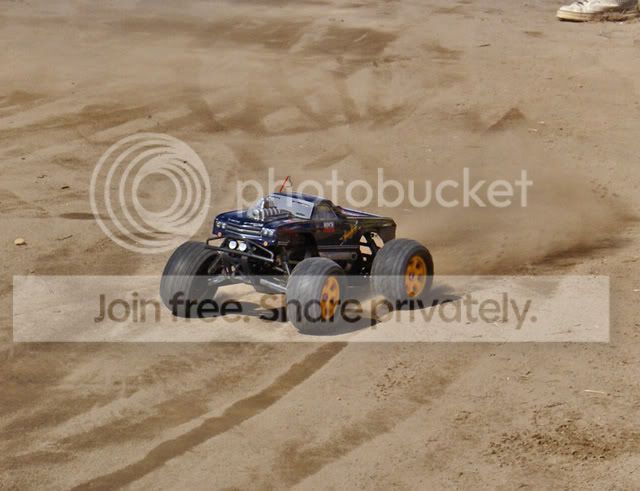

These are some action pics. It is very hard to show what the truck is doing with stills. But nice 2nd gear wheelies are a part of it.
The pipe is so awesome in the entire rpm band with the OS30 and the now very hurt SF.32. Not to worry no crank damage and this is after 6 Gal. of fuel in it.

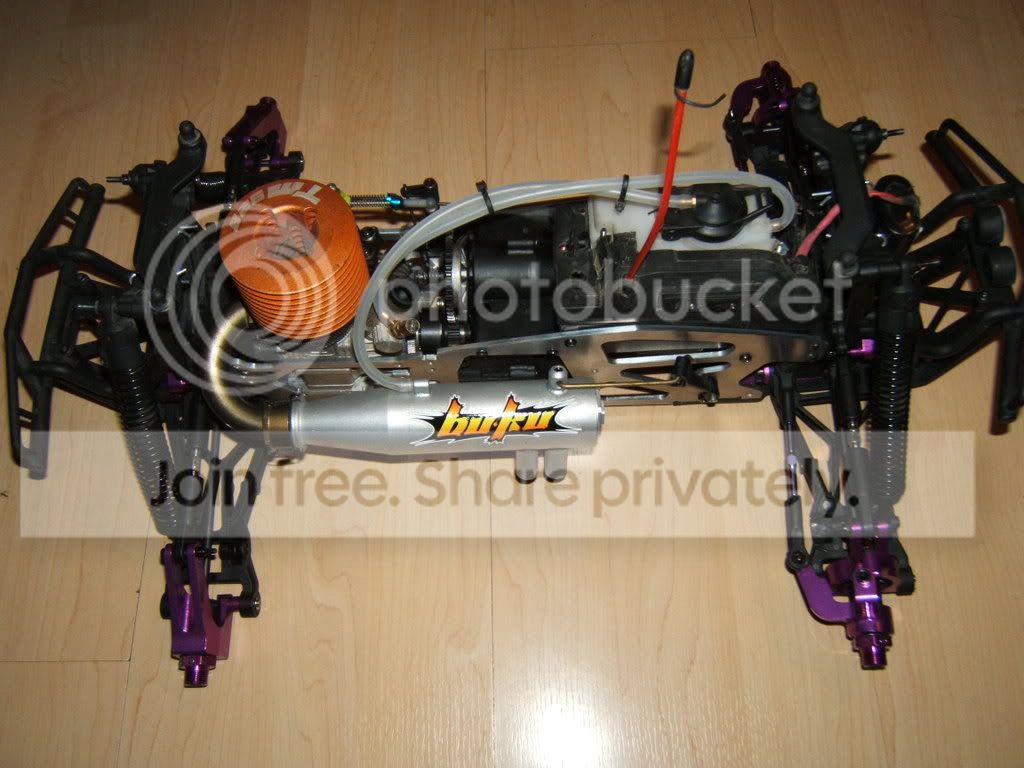

I ran the BUKU in the savage at the Halloween bash at the diggers dungeon.
The BUKU is a great pipe. I ran it all weekend without a flaw. I jumped 45ft. 8
in. But just out of bounds in the long jump. Could have been great if I was a
little straighter. Oh well that’s racing. Here are a few pics of the pipe and
truck it will rezide in.
