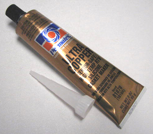

What are you using to seal up your motor? I need to seal mine also.
Most use hi temp ultra copper silicone gasket maker or rtv as it is called, permatex brand seems to be the best one to use, available at any auto supply store or even Walmart and most hardware stores
Where all do you seal it at?..just a bead on the o rings on the carb and Inbetween the head and block and then on the back of the block?
https://www.hpisavageforum.com/threads/nitro-engine-sealing.15150/
before you seal anything clean clean and clean all parts before and let them dry well...... I let my sealant setup a bit before any reassembly about 20 mins is good......
