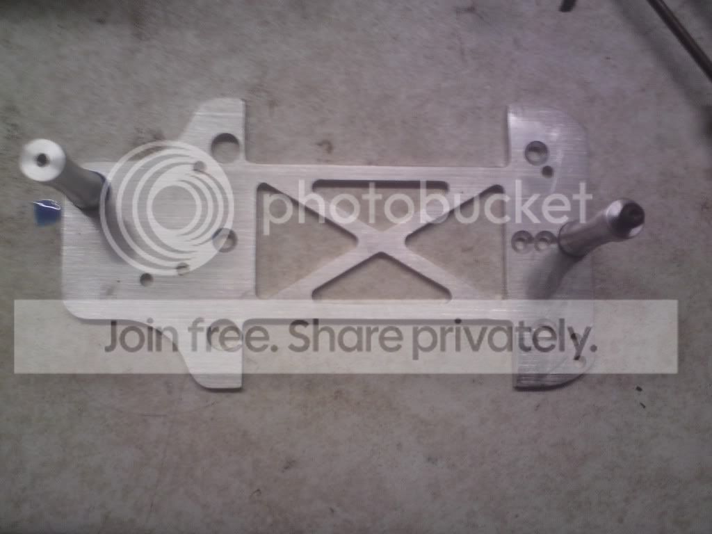

Hi,
I have finally got a my mid tank build finished. Firstly can I say a big thankyou to chimeraxp and oregonmud for there knowledege which has helped me allot thanks. Also Rob at innovative rc as he was very paitient with me and accepeted parts returns without a problem (found that the irc box canot be made to fit with flm tvps). So this is the parts list I used.
Ofna 250cc tank
IRC Tank plate
IRC front tank brace
Engine mount brace
IRC servo linkage
FLM servo mounts
IRC Tanks mounts
IRC Throtlle servo bits (combined with my throttle mod bits
RPM reciever box
I think thats about it

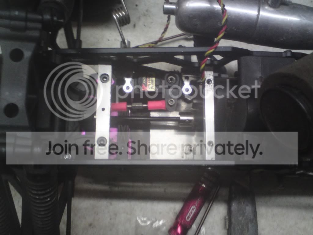

I couldnt believe how easy settnig the throttle linkage up was took about 5 mins.
If you see something wrong please tell me lol

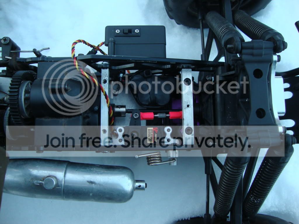

So here are some pics.
Humppack fits nice and snuggley lol

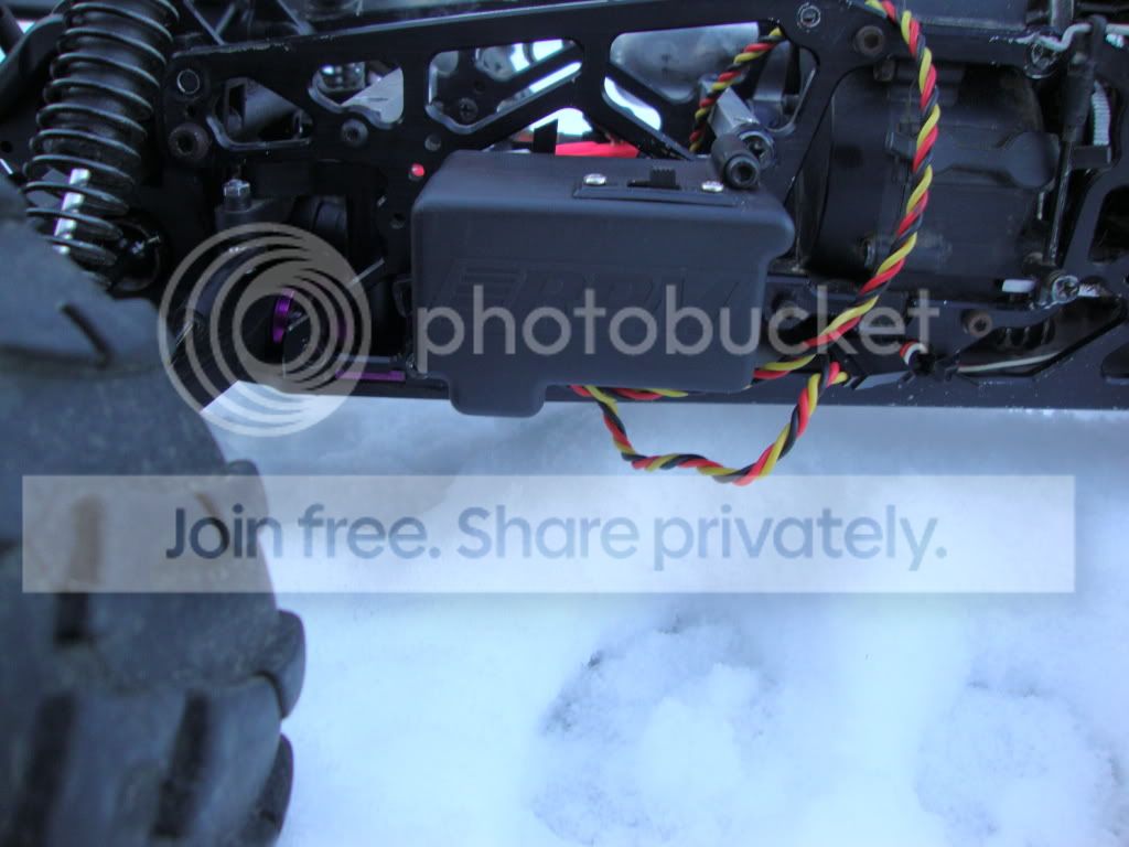

Got the rpm box mounted and electics inside.

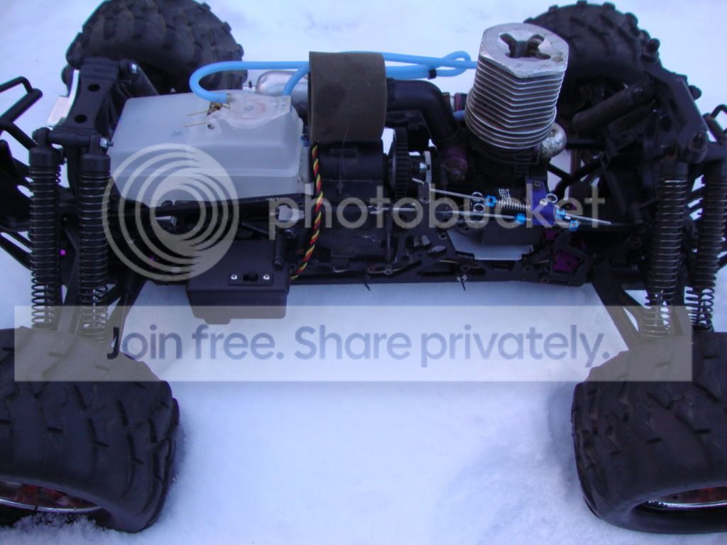

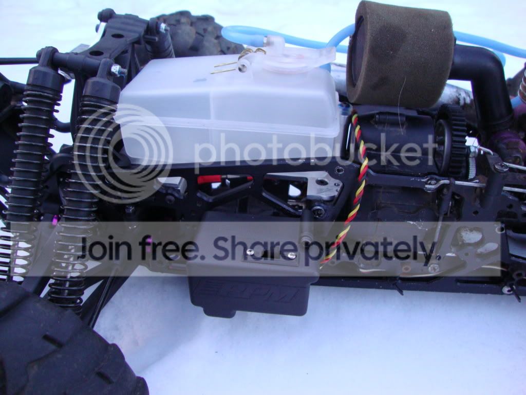

Finally finished
Thanks
Elliot
Forgot to mention. The IRC plate need a few hole drilling but fits really well also it cost less taht the material would of if I had of bought them :)
looks good . gotta love the black flm tvps.i see one small issue with your throttle linkage. the slider for the throttle could be flipped so its on the inside of the pivot bolt. it would make your linkages more parralel
