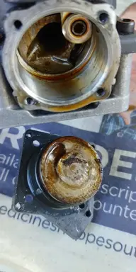

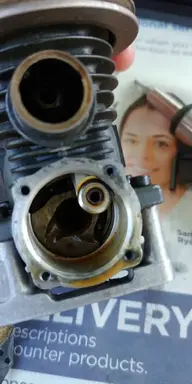

Here are some pics of the internal while I was changing out the pressure spring and starting pin, I think it looks fine?
The engine has good compression, hard to turn while the glow plug was in

Doesn't look too bad, could use a good cleanin though. What does the top of the piston look like? How are the outside temps & humidity when your tryin to crank it? Try the needle settings next time and maybe just slightly open the carb a little more to keep it runnin.
yeah I cleaned it all before putting it back together

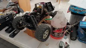

Good morning guys and happy holidays to all. I need to thank you for all the ideas... I started my savage 4.6 after two - three years and what helped is "If the internals and compression are good, set your needles to factory then lean out the LSN about 1/2 a turn and the HSN about 1 full turn" by @xtremsavage. It wouldn't start at the beginning. Now it is awesome as it used to be !! fyi, I am using 10 years old fuel !!!
Thanks again wishing a happy and friendly 2025
