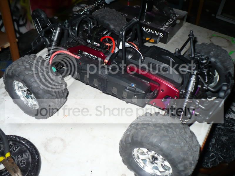

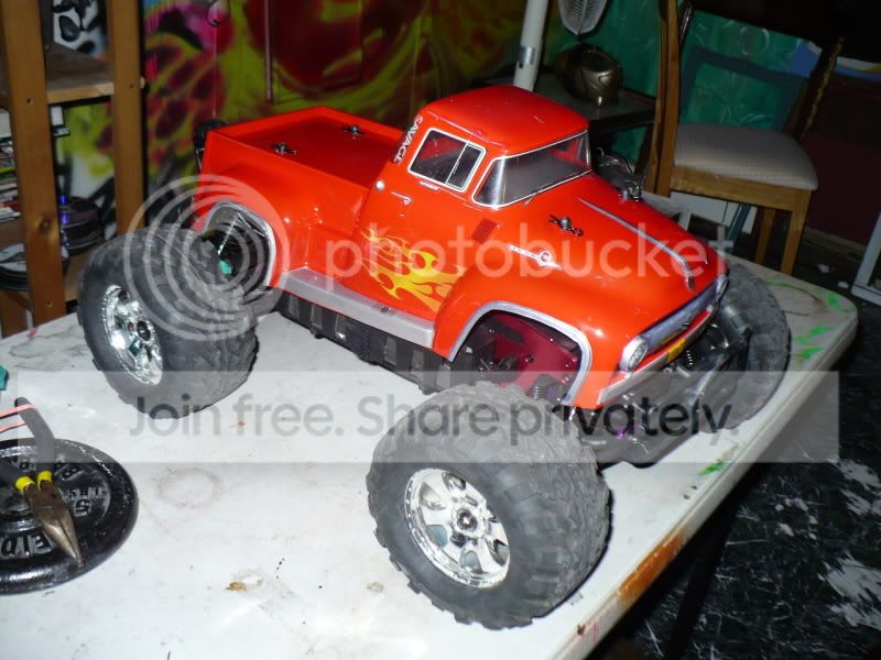

my flux is my main project next to my XL =) these are some of the things that i got in the mail this week to throw onto her and a couple of shots of the truck
I also just threw a Hitec 7950TH servo onto the truck. the torque on this thing is nuts!
