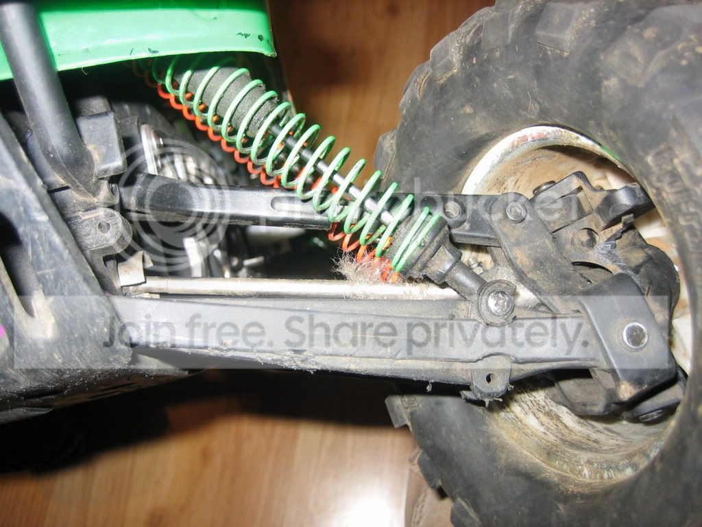

Well I got my IRC shocks in today and can't wait to put them on. Only one thing..... I got cought up ording the shocks that I placed for an order for savage X with non-X arms. I do have the savage X BUT its the savage X 4.6 dang it. My question is on the a-arm there should be hols on top and bottom of it. mine has holes up top and the mounting brackets won't mount. Do I need to buy a whole new mounting set from IRC or can I buy new/old savage x a-arms and put it on my savage 4.6 Well a nother rookie mistake READ THE WHOLE THING!!! Thanks guys!! Cheers!!
Here is a picture of the Savage 21/25.
The X arms and 21/25 arms are interchange.
yea just buy some good used arms and you will be ready to go......:smiliejam: or maybe somebody on the forum will trade you?
