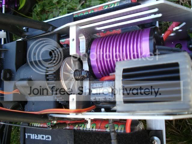

I though I wrote a reply to that before. I probably never hit submit though. I do that a lot. Your e-max probably doesn't flip quite as easy if you give it that little too much throttle too. With a 3 cell the throttle has to be applied ever so gently but it is still fun. But alas on topic instead of a brushless lst2 I have decided to do this http://home.comcast.net/~milemarkers/SavageBrushlessConversion-Movie.htm. It's that bit cheaper not having to buy a new car.
At first I though he was really good at controlling the power but then I realise there is a really low wheely bar there. I am actually probably going to make up the engine mount myself. something more like this guy has done http://www.maximummt.com/phpbb/viewtopic.php?t=34593
I discovered a work mate has access to the tools required to do it. That and I will probably need to custom make my battery holders anyway.
Wow... This is a well thought out truck. For Savage lovers, it's something to keep in mind.
I personally think the LST is the way to go for an affordable and more accomidataing platform form for the Electric application.
It just has more realistate to work with. What's the going rate on this guy here?
By the way... Nice find on the truck here, TIM
yeah LST is the way to go for sure but thinking about it if I got sick of the savage there isn't really any problem moving the electrics from a savage to a lst and changing the savage back to nitro.
But that is a really well though out truck. I have found for converting a savage to brushless the place to go for info is http://www.rc-monster.com/forum/. They really seem to know their stuff when it comes to brushless.
And that truck would be really nice as a racer. The COG would be real low with the batteries mounted where they are.
Yea.. it's definately a sweet truck, Tim. Can you afford it?
Or should I say , how much is the cost of that thing without the body?

Can anyone tell me if there is enough space to mount a 145-150mm battery in between the gearbox and the shock tower with the low cg flm chassis? It looks like a really good place to put a battery but I don't think it will fit. Can anyone prove me wrong?
Edit: I have proved myself wrong. It's about 20mm short. there isn't a chassis which is extended at the front is there?
