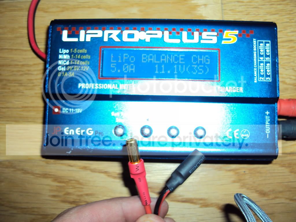

lets see a link to the charger/balancer your using.
should straighten itself out after a few cycles but lets start with your charger/balancer
also, does your charger/balancer have a balance cycle separate from a charging cycle.

the charger i own
info on charger
http://www.jperkinsdistribution.co.uk/downloads/4402900a.pdf
