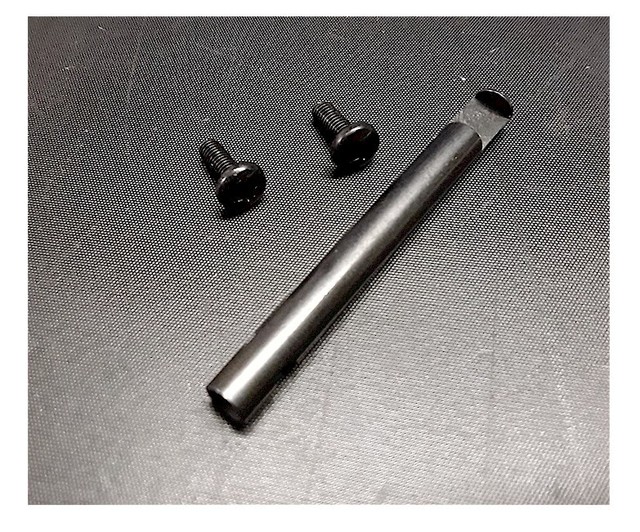

looking for info on a 2 speed trans brake lever portion exploded view.
Mine seems odd
Mine seems odd

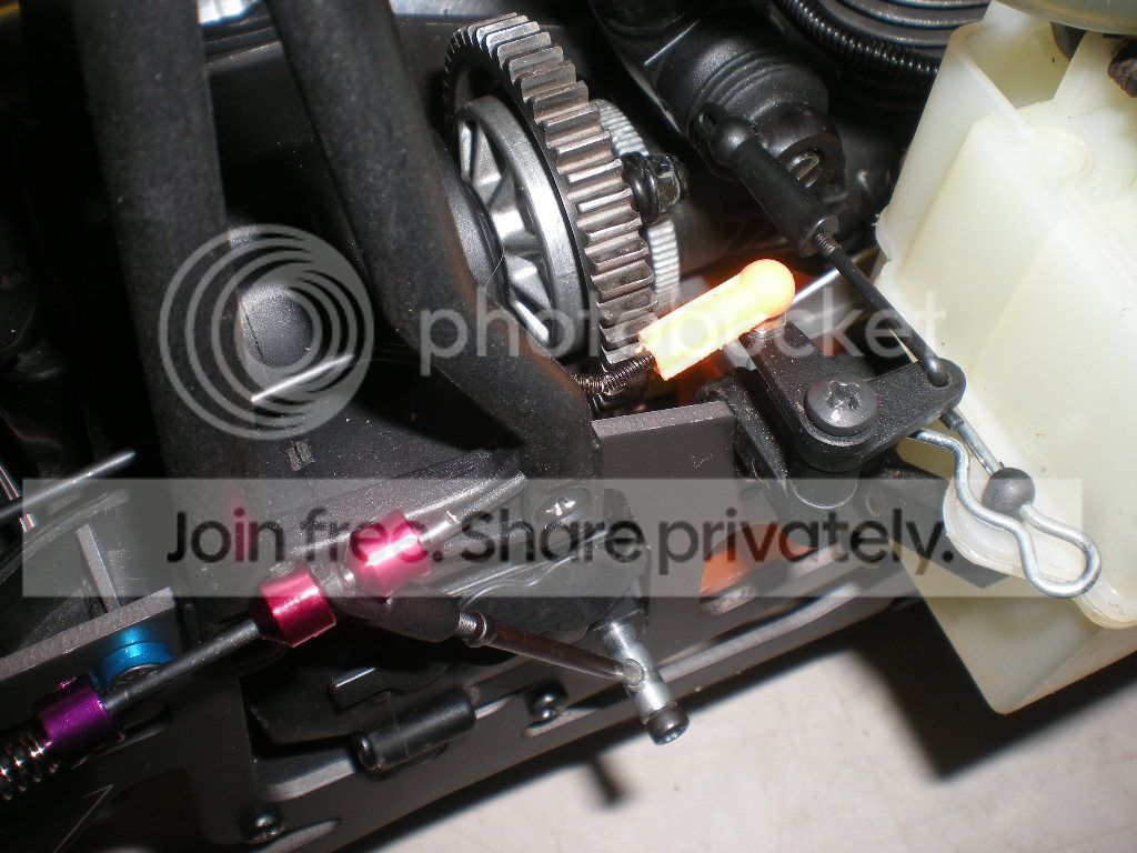

Try adjusting the brake adjuster(seen in pic) ,Mine sits like this with minimum travel to engage the brake.
also a short piece of fuel line ( one inch or so ) on rod between brake servo arm and adjuster .
Yes. There's a brass plug in there that pushes against the back of the "brake pad". Usually if the screws come out far enough for that plug to come out far enough for the shaft to fall out... the plug is usually gone. Or perhaps the very thin lip
