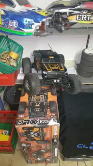

I and my son bought us a HPI octane and must appreciate that we are happy
But unfortunately it did not last long, because I have a problem with the savage octane. .. I bought it used and was told that is the octane new and I still retract muss..wie HPI video! ! ... To start but he goes on but somehow he does not stay long and goes to idle after a while ... and then pull back the same is the nornal when nan no gas is it? ..
I'm also the original insulator against another exchanged where should keep better .. it may be due to the carburetor or setting?
I am truly at despair because I want to make my son a pleasure ....

Here are two pictures 🙂🙂

Thanks for the answer... i make a video at the weekend an i hope you can me help me. .. i have also cleand all the parts ... the magnetic Sensor was a little bit of oil... t Could that be the cause.....For what is this magnetic Sensor well ?
Hi Guys
Engine running again ... it was .. retracted newly exchanged by the manufacturer completely yesterday and after that I did not notice that is in the 2nd and 3rd Switched .. any tips? I still have this video where you can see where I'm at full throttle but not in the 2nd Switches
