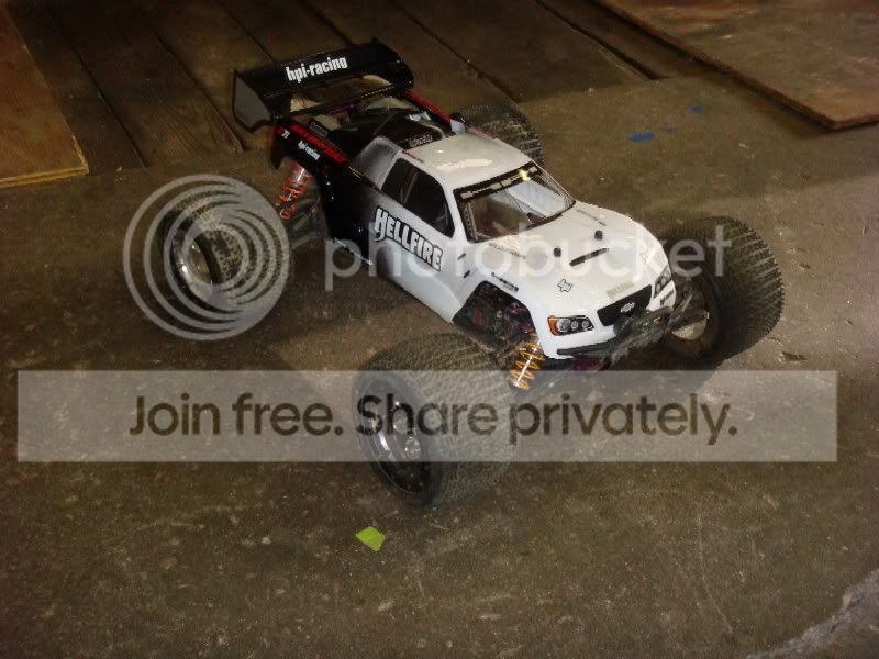

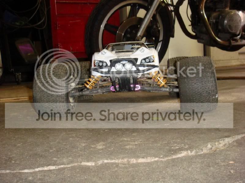

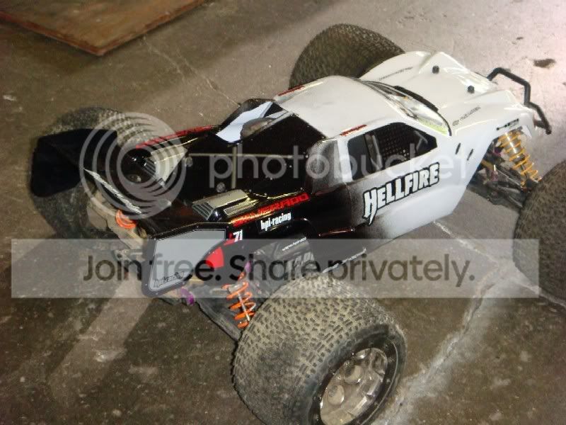

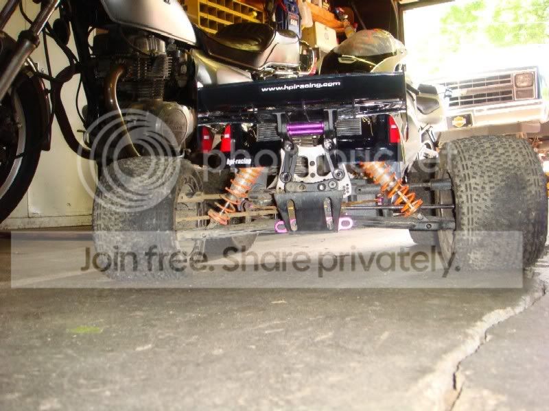

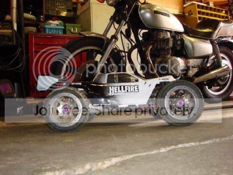

Mods to my Hellfire RTR are Integy MSR7 shocks, Hellfire SS rear drive hubs, JR radio gear, Sway bar set, Axial beadlock rims with Axial oversized Terrarizer tires, rear wing and 17T CB.
I plan on getting the alloy chassis supports, upgraded shock towers and the lighter spur gear. I havn't had any trouble with any other part of the Hellfire. The truggy handles very well and is balanced. The Hellfire with the 17T gearing has no problem out running my friends Savage XSS with the K4.6. I have no idea exactly how fast it is but it just screams weather it is on pavement, gravel or dirt.
Some parting pics:

Looks great. Man is that thing w-i-d-e with those rims on it!
I love the offset Axial built into the beadlock rims. With the tires out so far the stability is awesome at high speeds and the turning hasn't suffered at all.
