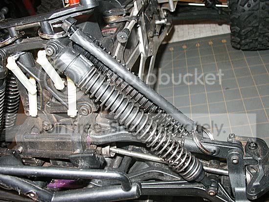

yeah nice info snoop just a little question on a different subject are they standard shock/springs if so how you get it to sit so low i like the stance it looks menacing lol
They are black springs (paints fell off most of them) with 35wt oil
all round & no pre-load adjusters.
Think i had Fullforce towers on at the time the pic was taken but
if not then they would have been Flm buggy towers on the lowest
setting.
Hope that helps.
Yes or internal limiters.
You could also try straps if you don't want to tear down your shocks
Straps for racing & remove if you want to bash hard
