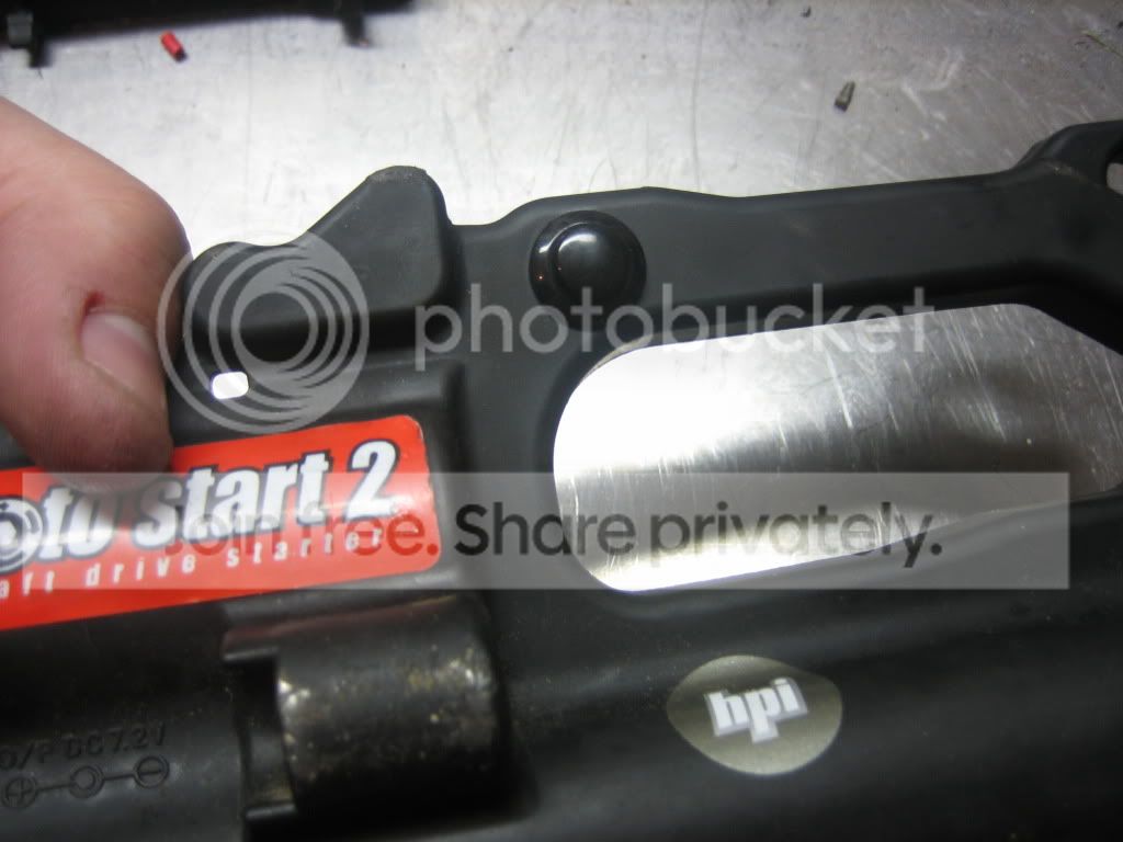

Alright, I was playing with my Rolo Start today and the button finally gave out. I know its the button because I took it apart and touched the terminals together via a screwdriver and the motor started and turned fine but when pushing the button it don't work.
I know others have had this same problem. So what did you do to fix them?

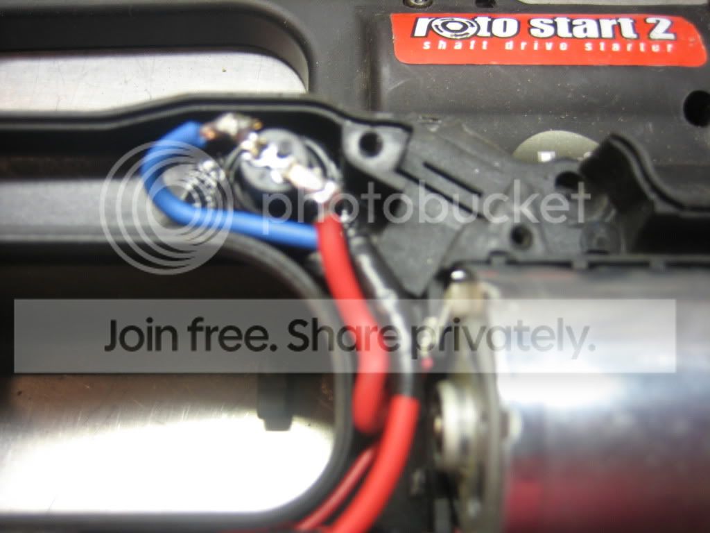

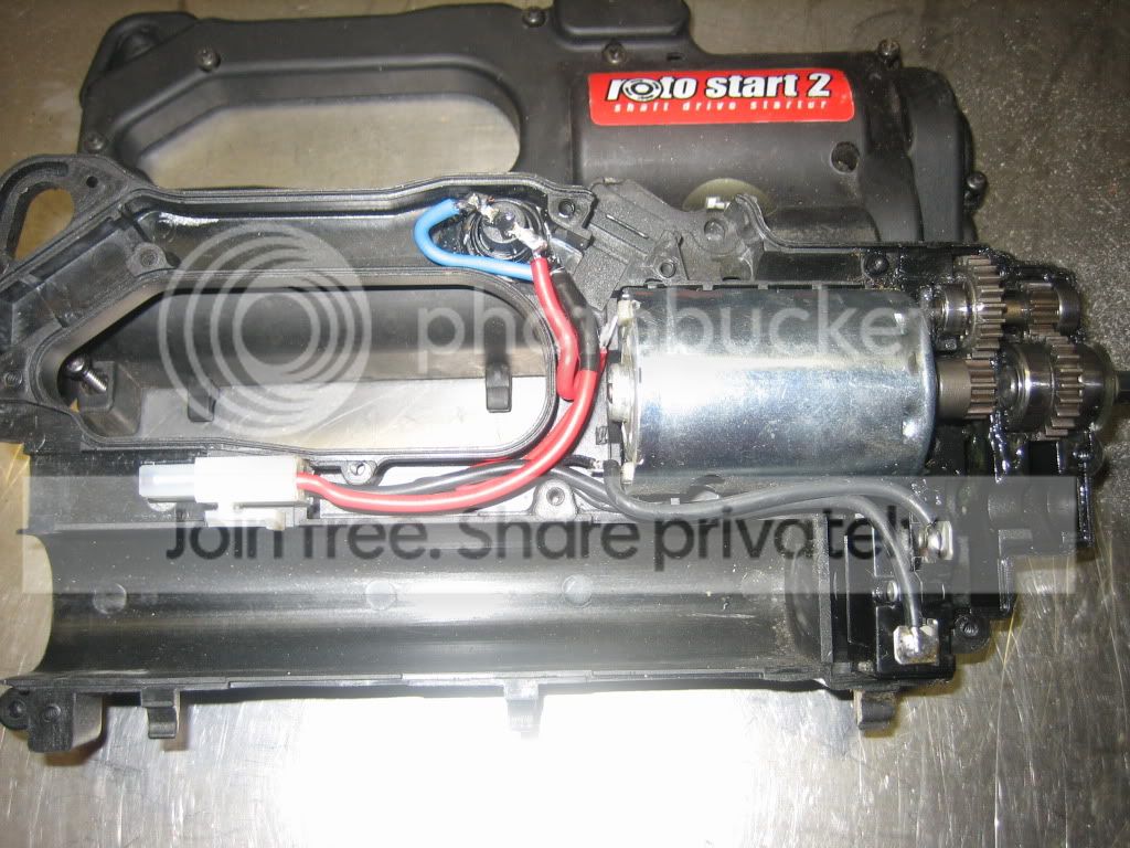

Alright, I got it working. I stopped at Radio Shack and they has this button that I thought would fit how I planned to get it in there. Anyway it worked great. I hope it holds up and lasts. Here are a few shots of how I did it.
Sorry I am no electrician. I wish I would have has some shrink tubing so instead I used Black Tape. Turned out OK.
