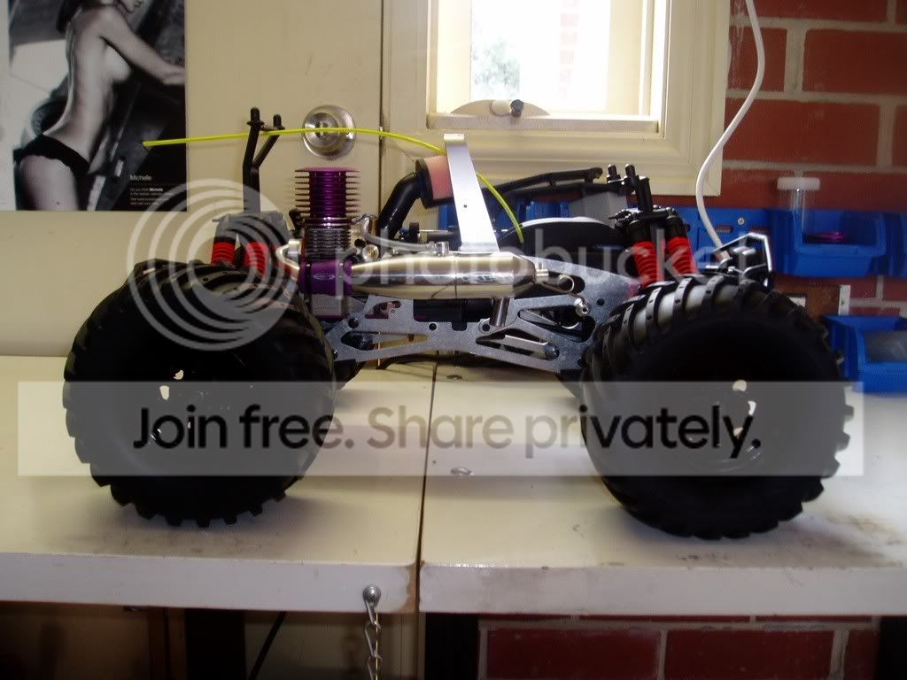

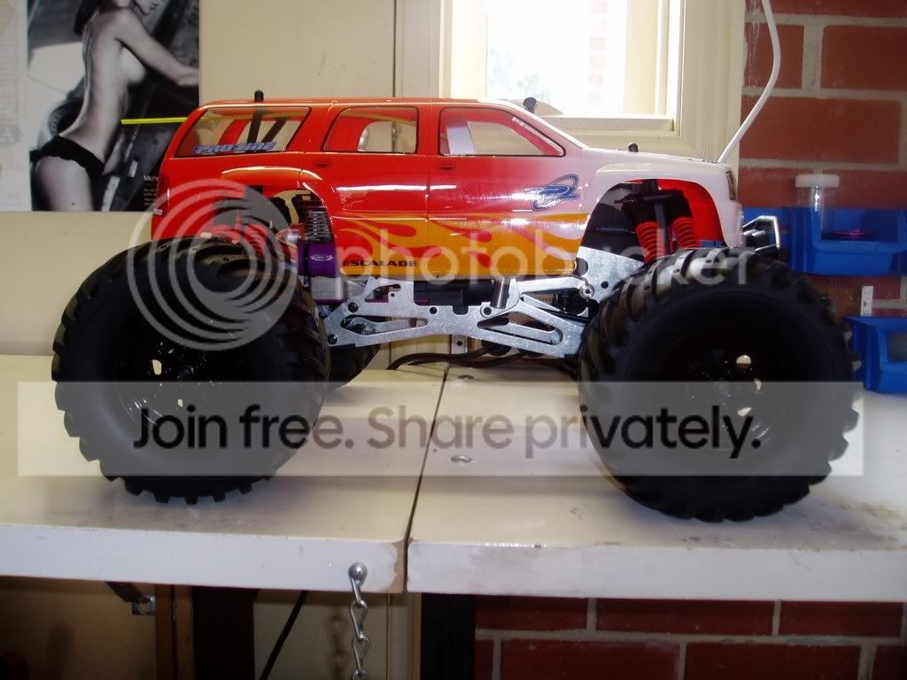

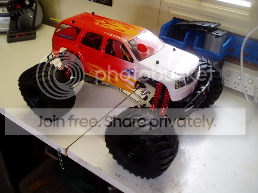

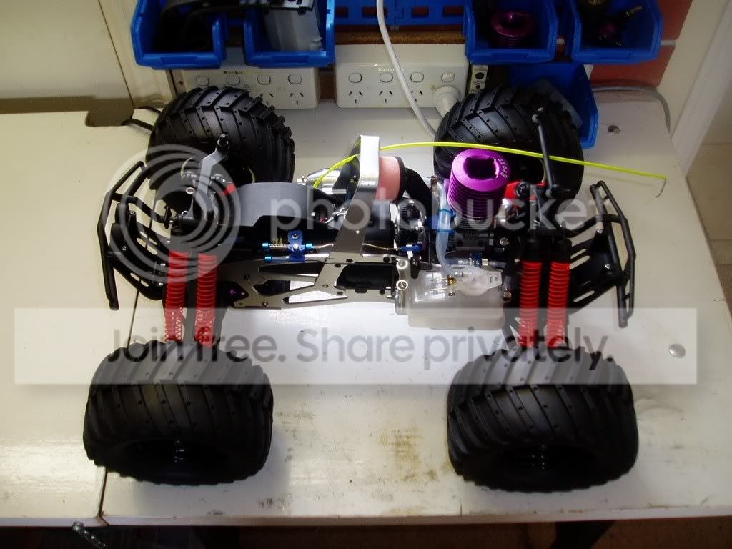

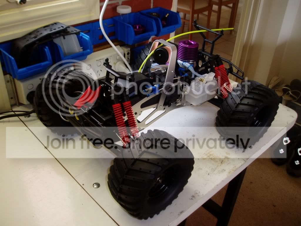

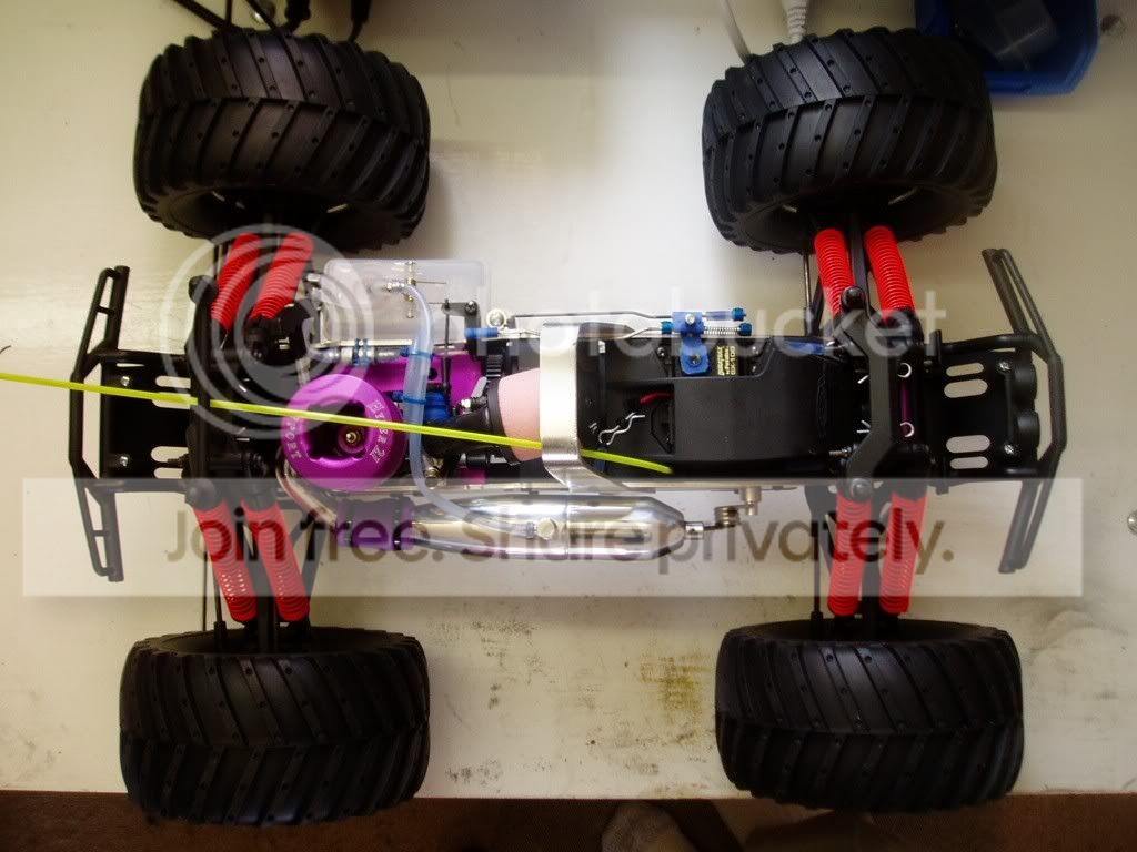

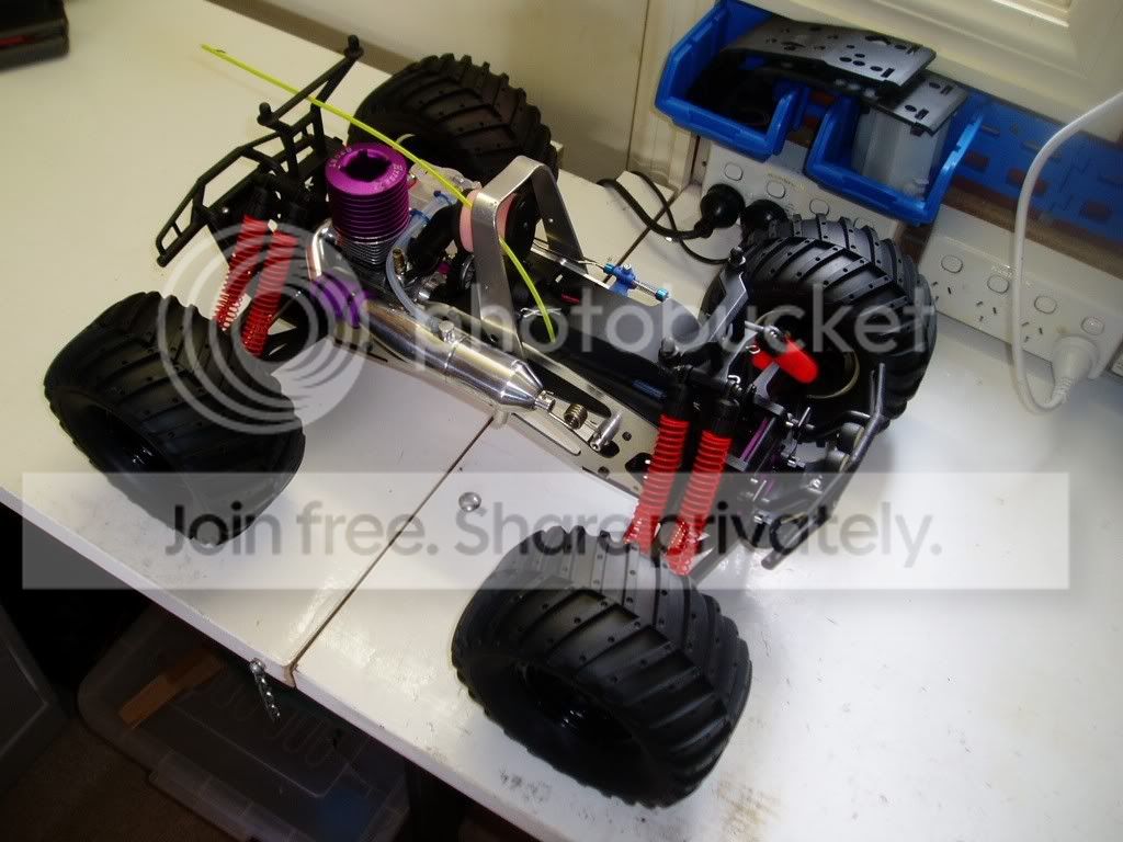

I was tralling through my PC today and found some photos of the last Savage I owned and did a full strip down and rebuild on.
It is a Savage 21 and was very run down and dirty when I bought it off Ebay. I did a complete strip down and clean. I replaced all damaged parts and then proceeded to customise it a bit.
These photos were taken just after the build was finished, so it is nice and clean.
It actually hauled!! The Hyper 21, Tuned Pipe and Big Wheels really made this thing scream, and it certainly sounded tuff!!

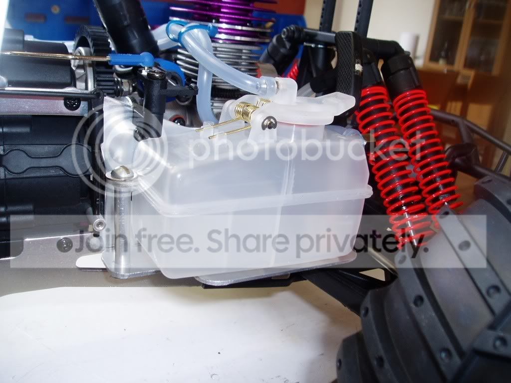

The OFNA tank mod worked really well and certainly was a much better solution than having the OLD Savage 21 style fuel tank on board.

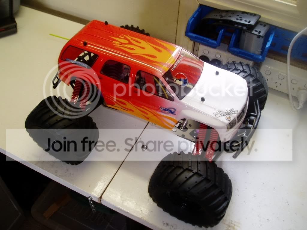

Looks like a fun rig! I also like the background in pictures 1 and 4 :cool:

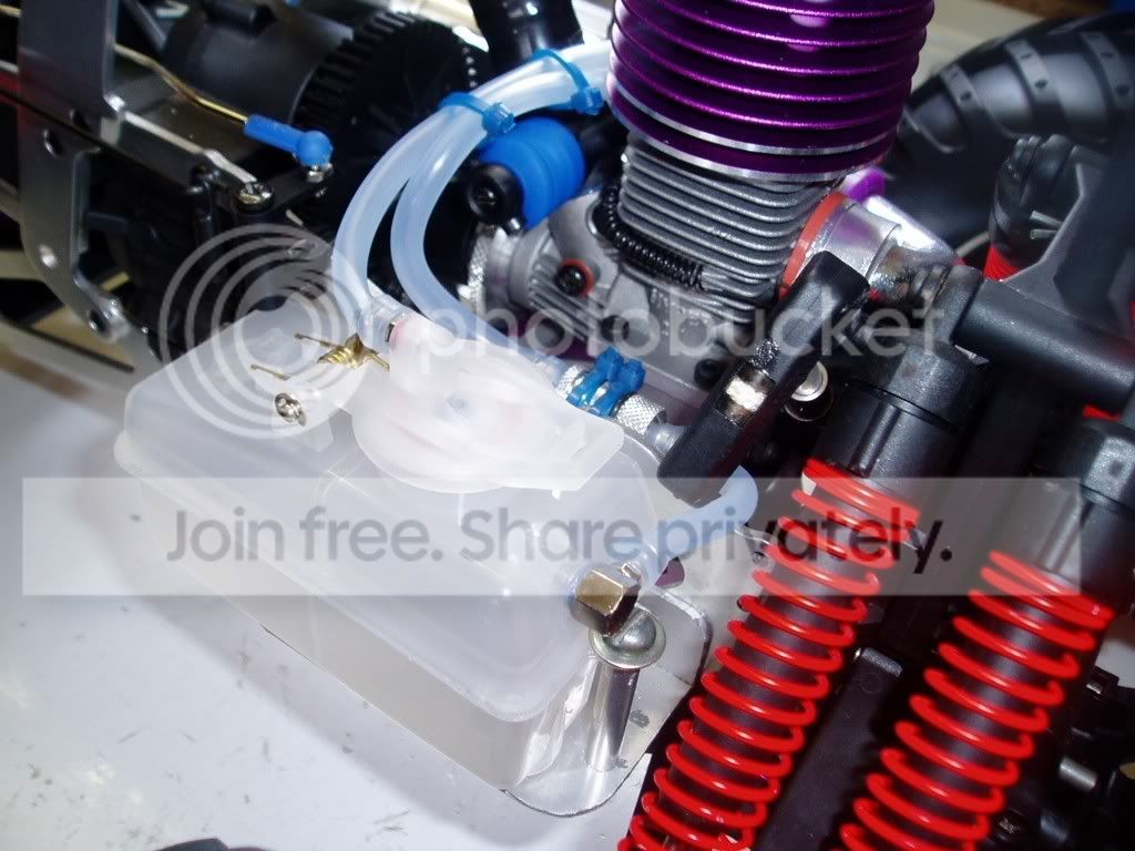

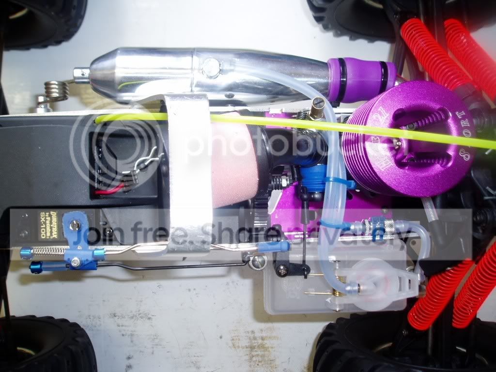

Basically, what I did is made the base plate from a sheet of 2mm alloy as alloy is nice and easy to cut and bend.
I cut it to a size that was similar in shape to the base of the tank, but ensure it was a little longer at each end to allow the mounting posts to be screwed on.
I also left a tab off one side which I then folded at a 90 degree angle. This is what I then used to mount the base plate direct to the TVP's.
I then used some hollow pieces of alloy tube and ran a long bolt through them. You can see the bolt goes through the tank mount, then through the alloy tube, then through the base plate where it is then secured by a nut and threadlock.
The fuel tube outlet on the back of the tank exits straight out on the stock OFNA tank, so I bought a packet of fuel nipples and replaced the stock one with a 90 degree angle.
This allowed me to have the fuel tube head straight towards the carb with minimal bends.
Hope that helps.
ya know...it's funny, but I had a hard time finding the truck in those particular pics myself...
but aside from those pictures, sweet looking work!!
