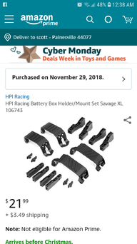

Hello. Thanks for the awesome answer. I don't think I've ever had to answer that detailed LOL. Well that answers a lot of my questions. I did order aside Saddles just in case they were only $21 so I figured why not. I'd like to fit the batteries in the frame but, they will fit in the frame , but the motor's just a tad bit too wide to squeeze two of them side-by-side. Screenshot_20181202-003814_Amazon Shopping.jpg I would have to angle them and stack them which is no big deal I would just have to build a little fixture in there. 20181202_010157.jpg 20181202_010203.jpg

actually now that I think about it I'd rather have the batteries on the outer so I don't have to take the body off when I change batteries. Hopefully those Saddles that I bought are good enough. Looks like they don't cover the entire battery like yours

Your missing the battery boxes!! It’s only the mouldings for the boxes your pictured!!! D36DF58A-C2A4-4289-A661-5AAFA92789DD.jpeg FA6A8E43-8464-4E96-91B5-64B396EA07F4.jpeg

Oh man! I'm going to look for that whole kit. I'll try and make them fit unless someone knows that they cannot. Thanks again!
