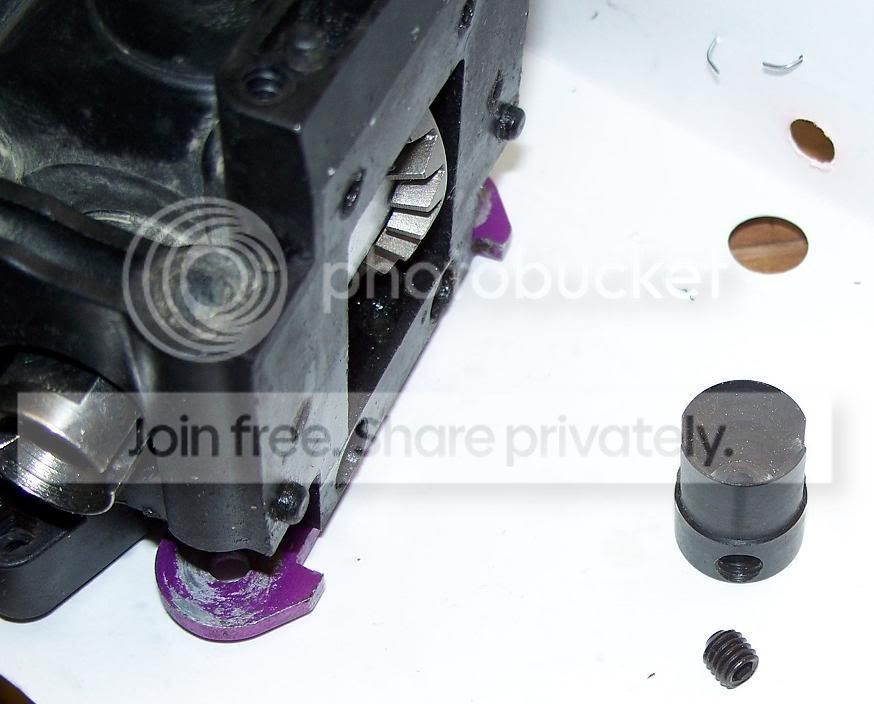

Holy **** they use a lot of loctite on these diffs. They are not coming apart in a hurry stock. I was able to remove the grub screw from the CV on the pinion without heating and that was it. The CV would not come off the diff pinion though. I used my heat gun and heated them up for a minute or 2 and they came off easily but there was enough red loctite there to lock about 100 screws. I used the heat gun on the diffs as well. I can see why people break these diffs in the cen though. The plastic cases are useless. They are so thin you can flex them with 2 fingers. They also don't seal very well. I don't understand how cen can make one part so well and the next so poorly.
Ah crap I was goona warn you about the red loctite. I actually had one screw break off in the diff cup, so I am only run 3 on one side. Did you figure out that you only need to take one side of each one apart?
Yeah I only took off one side. I was going to take off both sides but I decided after burning myself 3 times just trying to get one side off I decided one side it was. I learnt that when you drop something you have been heating with the heat gun DON'T CATCH IT!
I didn't break or strip any screws though. If the screw wasn't coming out easy it wasn't hot enough. The screws seemed fairly soft I noticed too.

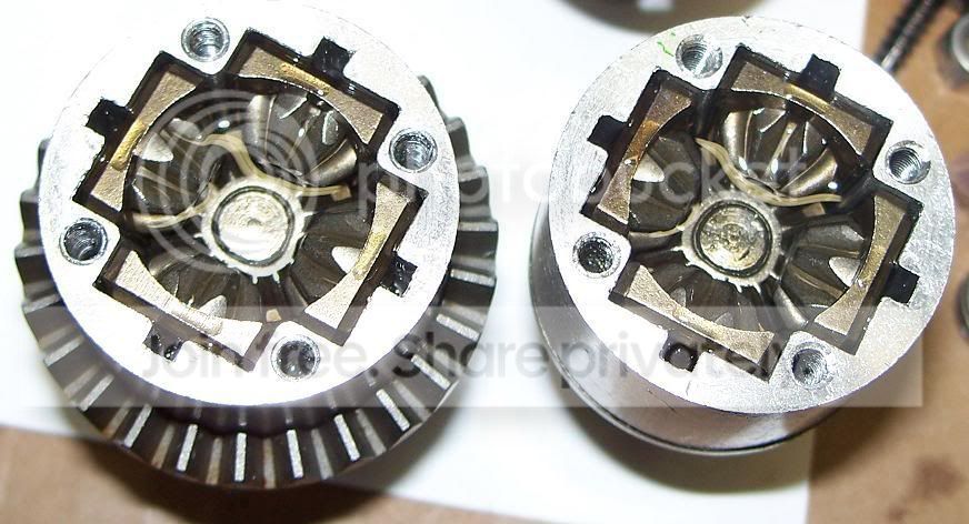

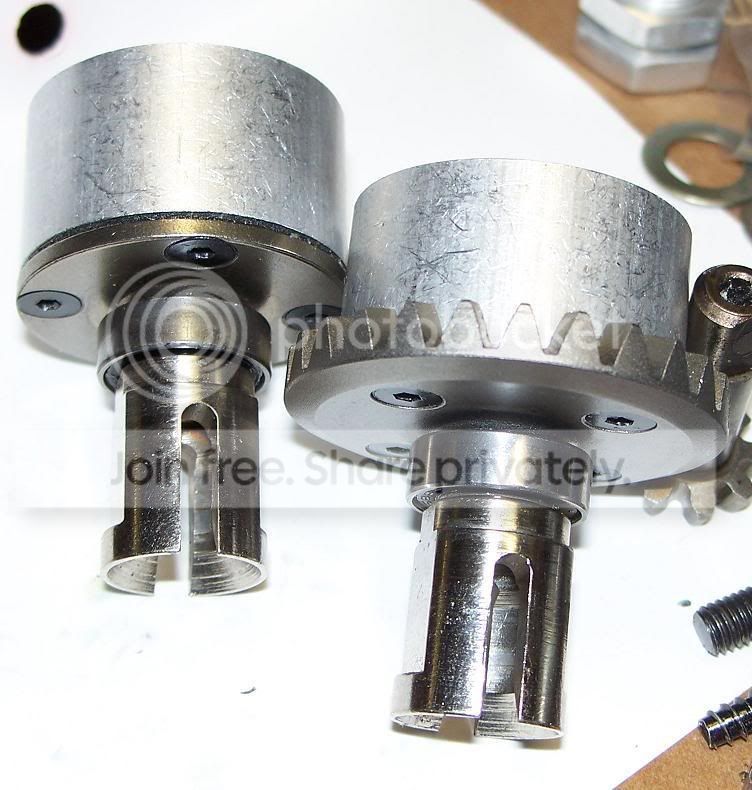

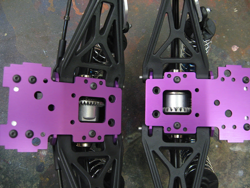

I finally finished the diffs. I know this same picture has been taken many times but I just had to take it again.
Yea I hope that you plan on doing the other diff. or your just showing the different between the 2..
Those are new not yet run savage parts. I just bought the bits I needed from nirtonutzz so I don't have the rest of the truck. Yes I have changed the front diff as well. I just took the pic half way through for comparison. It's crazy how much bigger the teeth are on the Cen. Also after putting them all back together i realised I forgot to put any grease on the ring gear :duh:.
