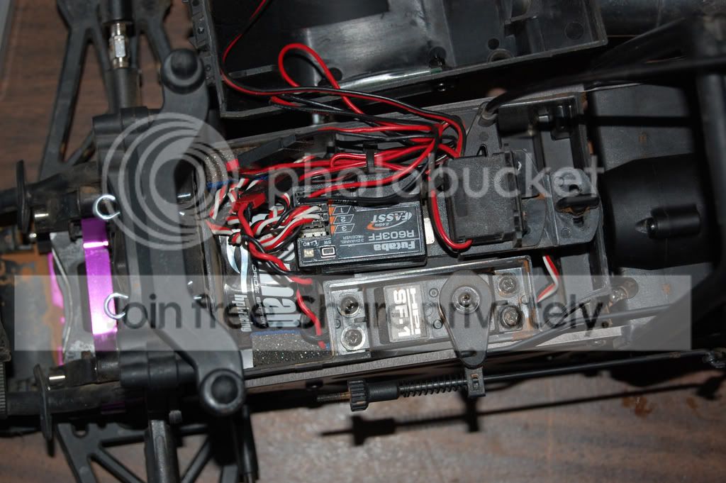

Hi. One question. How will fit the FUTABA FASST receiver into my X4.6 stock radio box? I also have the charge lead and battery level indicator. It goes as the standard receiver or it requires some mods?
Thanks
Thanks
The Futaba FASST receiver is smaller than the stock HPI reciver so it fits with no problem.
The battery indicator bolts right into the radio box and plugs inline with the wiring.. its really easy to install...
I know about the battery indicator and charge lead. They are already installed. I was just wondering how the Futaba receiver will fit..
Thanks for the reply!

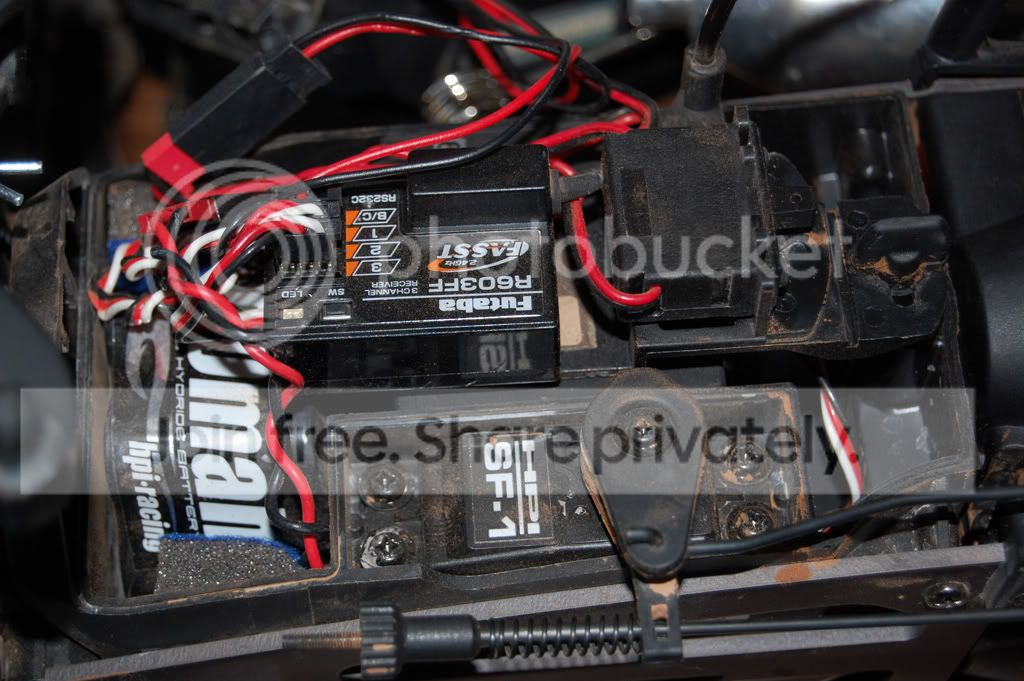

Here is some pictures of my Futaba FASST RX mounted up in my radio box.....
