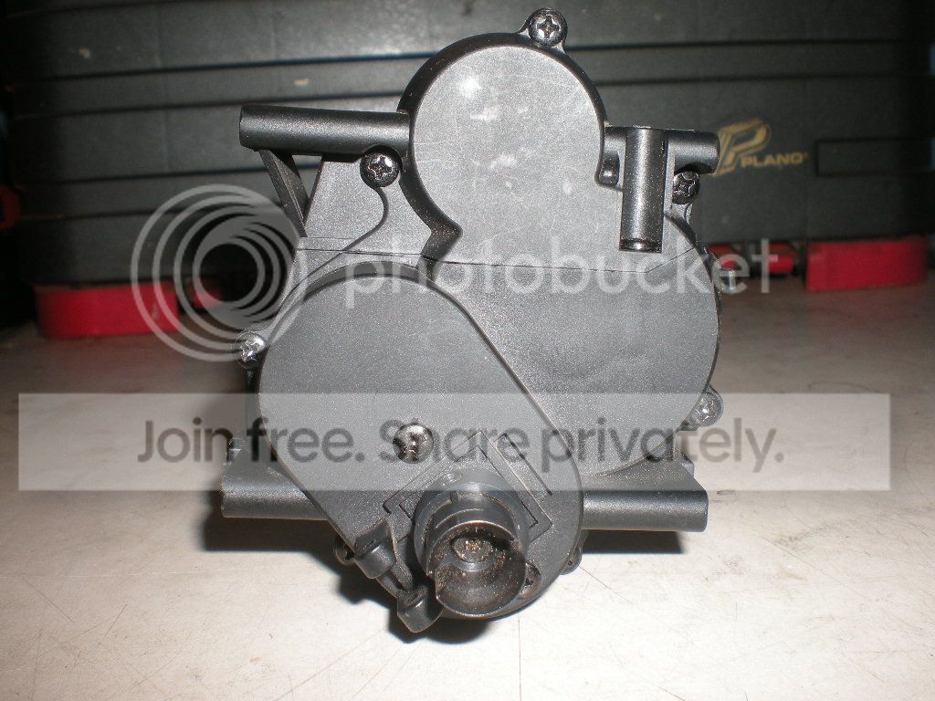

I would start checking the setscrews on the output cups on the transmission. sounds as if the rear one ejected and became lost......

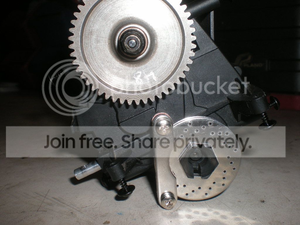

this pic shows the spur and brake discs, where the brake discs attach is the drive cup, there is a set screwpin on the cup holding it to the trans shaft.... same thing up front just no brake discs......

found the shed keys checked an it was the brake cup set screw ordered more and got some lock tight thanks for all yours guys help thanks
