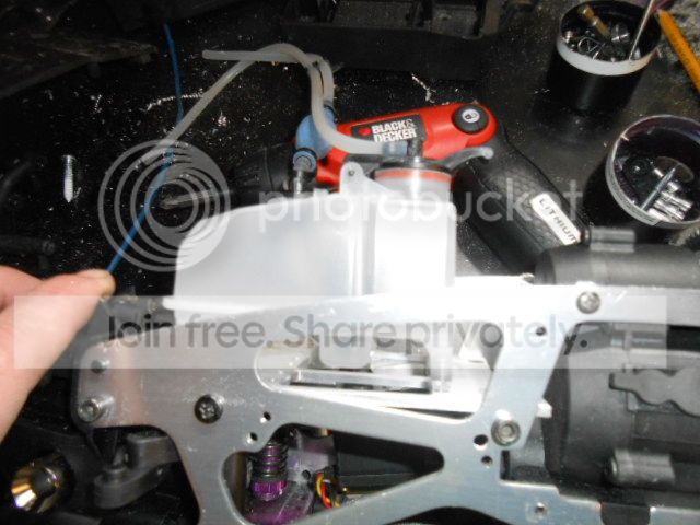

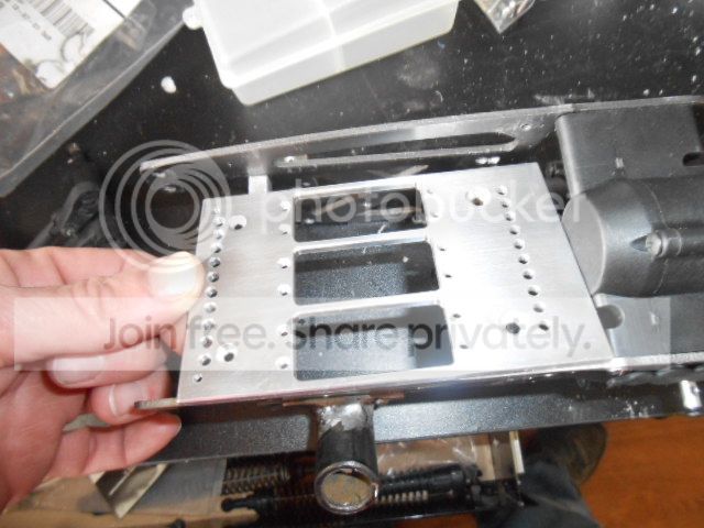

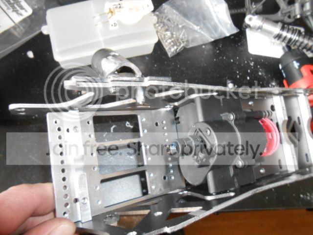

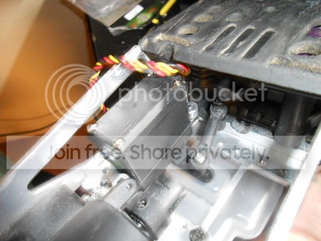

Do you guys have any pics? havin a issue with clearance .. wants to hit the tranny post links or pictures below .. thank you guys
I wonder why it's hitting? I know the FLM TVPs are the same length and everything as stock TVPs from the trans forward and it's designed to fit FLM TVPs. On a side question, does one of the cross braces for the plate attach to and secure the top side of the steering servo saver?
Yea man its there right to I believe my man its only hitting like a eighth of a inch just don't wanna hack on it if I don't have to

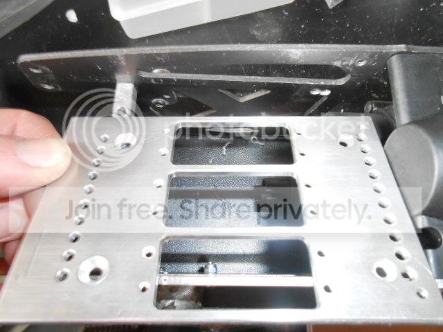

Did you try spinning the plate 180*? I checked out FLM's website and looked at the pic of the servo plate and it looks like one side is longer than the other in relation to the mounting holes on the plate. Just a thought.
the one brace on the plate is not threaded on the one end (two of the pre drilled holes) .. i am using that end. I have the side with the no threaded holes .. and are using them for my servo saver
took it back off and tries the 180 spin .. made it worse. the plate seems to me can only go one way cause of the larger predrilled (no threaded) holes on the front side
Do you get raise it up a little on the stock chassis .. if so how to you compensate for the servo saver mounts ?

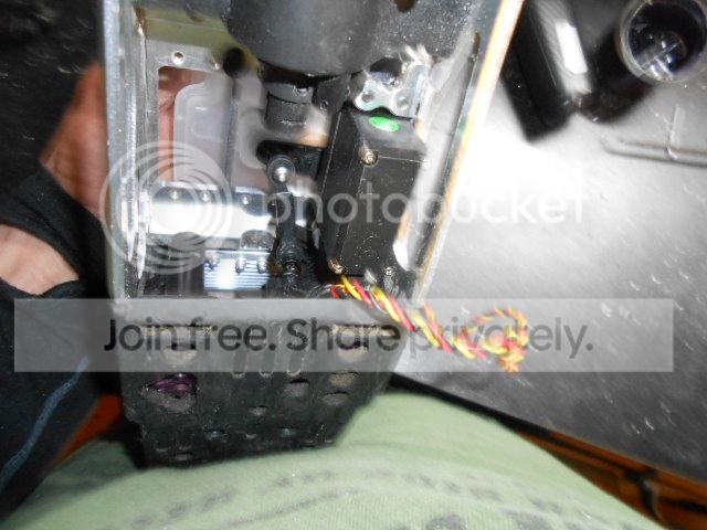

I got it man just timmed it a little .. now steering servo install .. any thing i should know about ?

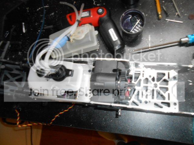

so was board and thought what the hell lets try again .. I really hope the steering servo will work .. it seems too any thought on this ?
even mounted the tank :p
