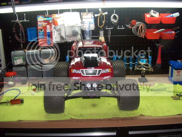

Here's my first attempt to paint a body.

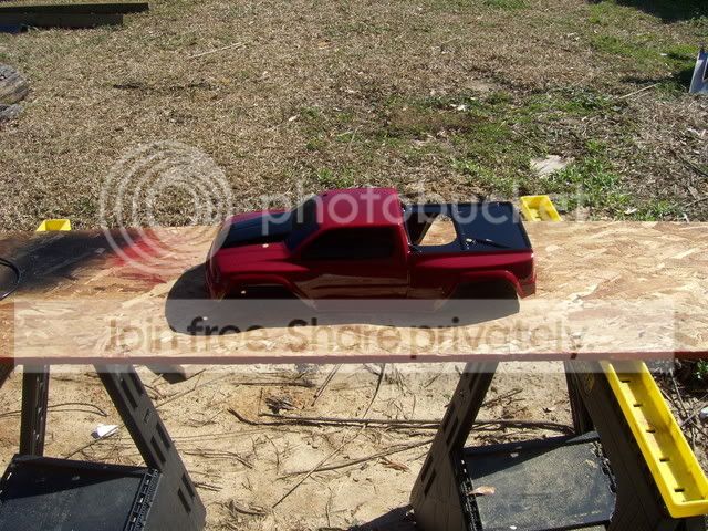

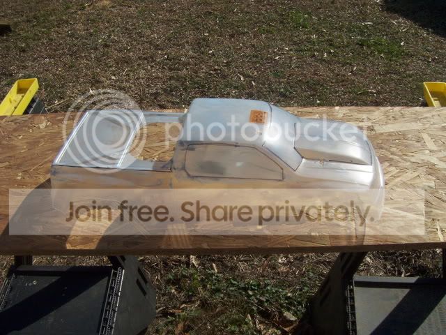

I used liquid mask to paint this one.

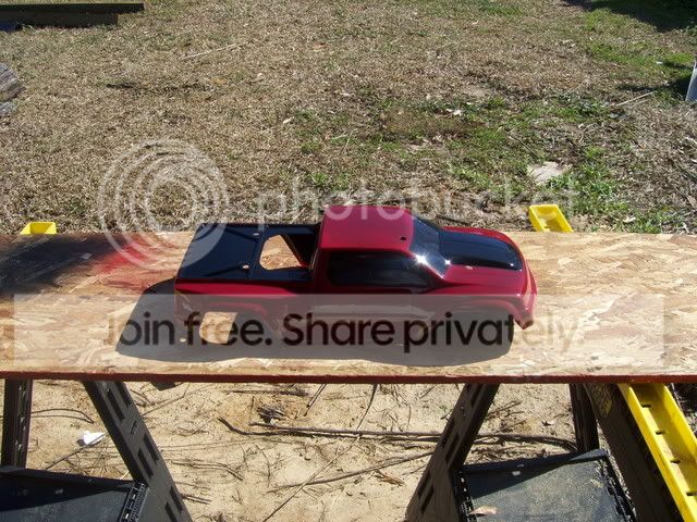

Here it is with the paint on it.

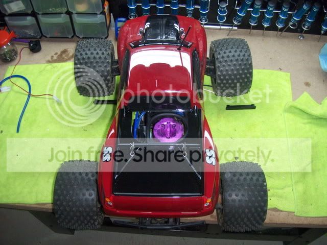

Here is some with the decals.
Looks good from what I can see. Boy, I guess I really do need to try liquid mask. How do you mask in a straight line with that stuff? Do you have to mask off the liquid mask?

Looks nice bro. Now put them decals on and show us some more.
No Drivefast, Liquid mask is just a liquid you paint on basicly and let it dry. Then cut where you want your designs if any and peal it off in that section and keep doing where ever needed.

Ah, so you liquid-mask the entire shell and remove as needed? Makes sense, if I follow you correctly.

No just paint it on ( the thicker the better ) and use a Sharpe to draw your design on the outside and use a sharp hobby knife to cut along the line and peel it off, if you make a mistake just apply more liquid mask and recut. On a personal note for best results let it dry over night ( I know that this is hard to do), I used a hair dryer but the mask was still a bit tacky and not complete dry in some places. I liked using this product and will use it from now on.
Nice paint job. Is that the GT2 body from HPI? Yeah liquid mask is the way to go. I used when I painted my last body, except I only masked off the areas that needed to be masked and brushed it on. I'll be using LM when I get a chance to start paint the body for wa2ruff, as soon as the wind calms down and I can get some practice in with the airbrush. Also, another note on use with LM, is once you have your design laid out, you can go ahead and score all the lines of your design before you start painting. You at least have to let it completely dry first. That way, if all you lines are already pre scored, it'll make it easier to move to the next color with out having to fight trying to see the next line to cut. And if you wondering, you won't have paint bleed through if you prescore everything first.
