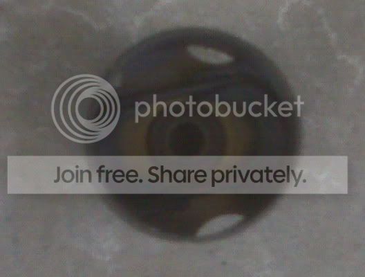

Well a few weeks back I went down and met up with Deathrage for a bash before he got deployed again. We went to the first bash spot which was a construction area. Hill, dirt, and some hay. Well needless to say I don't think the fironi clutches liked pushing his truck with the gearing he had and the tires.
After we went back and figured that out we grabbed my truggy and went out looking for another spot. Found a great spot and went bashing for probably another 2 hours or so. (Videos uploading)
Parks what gearing was the rager using when the clutch got bar-b-q'd?
also, which shoes?
I have no clue honestly. Thinking like an 18/47?
I don't think his gearing helped at all, but when we was at his house he was doing wheelies down the street so I don't know.

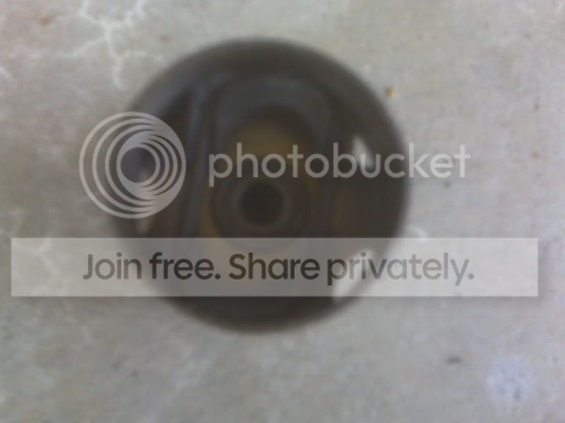

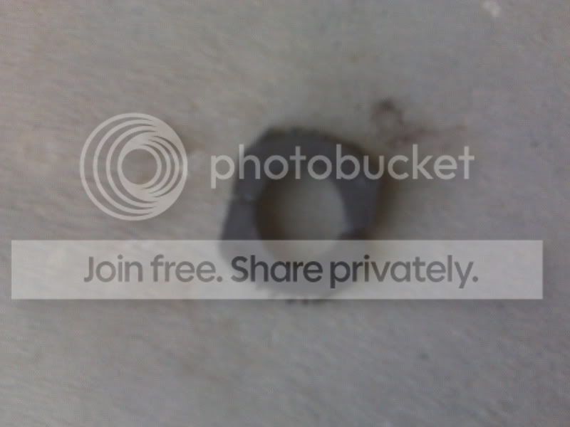

Shoes were black is all I know, They were stuck to the CB. Spent 20 minutes getting the CB off the mill. Pictures were taken with a cell so they suck. The springs were worn through the shoes.
First I have seen this, I think the tires/high gearing is what took these out. I love mine and haven't had a single problem with them.
I see the problem. The springs should face away from each other he had them facing towards each other causing the cluch to hang up open and burn up the shoes.
