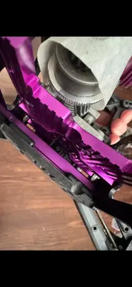

It was at about this point I noticed things did not want to fit together, and I initially thought it was because somehow, Savage X bulkheads put the diff input at a different angle or spot and it hit the engine plate. It wasn’t until looking at the pictures on HPI’s website that I realized the low ch plate has a cut out in the back to clear the input cup, not just extra clearance down the middle for the chassis. DOH!
I then discovered Gazzmann’s thread on asking if anyone had a low cg mount from a few years back, and seeing the solution of just cutting a factory plate and support, and drilling and tapping an extra screw for support, so for the time being, the drive cup is removed and its front wheel drive! The original engine plate will donate themselves to be modified in the future. For now, I cleaned up the transmission, radio box, installed some Amazon servos for throttle/brake and steering duty, used them a few times and been happy with them so far for the price! 35kg for steering and 25kg for throttle action:
View attachment 13182View attachment 13183
