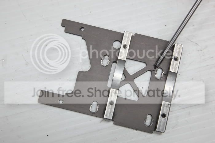

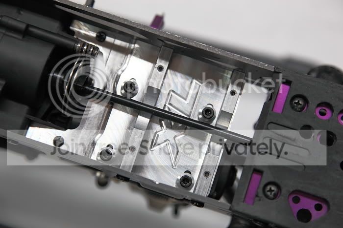

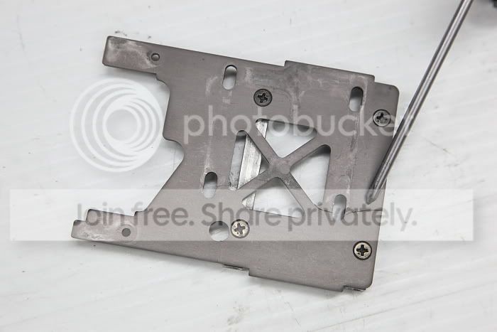

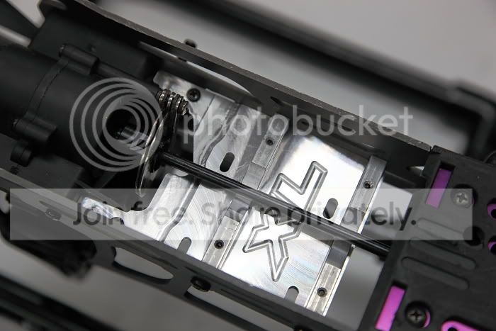

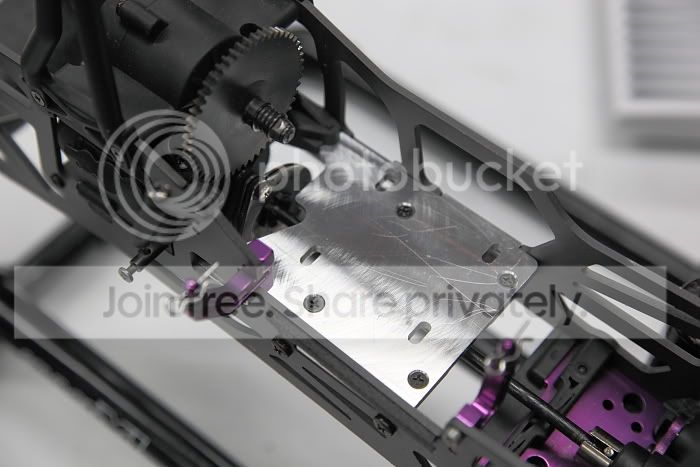

Since the LHS's don't have one in stock, and the HPI is going to be a while, I decided to make my own...
I made the plate without lightening holes, and the thickness under the engine mount 4mm over the stock 3mm.
In order to shave some weight, I shamelessly carved the XL logo on the bottom side and thinned out the plating to 2.5mm at the tranny end. The final result is it weighs 59 grams, 14 grams heavier than the stock 3mm plate.
Took Fred's advice, had to go with 4mm x 12mm engine mount cap screws over the stock 4mm x 8mm to compensate for the thicker plate and the cone washers on the bottom side.
We'll see how long this one lasts.

only question i have it the ears that connect to the tranny. on my 4mm c/f plate, i had to shave the top of the ears for fitment & mesh. yours is shaved on the bottom; everything line up and spur & c/b mesh ok?

Thanks Shaun, great looking plate as well, the only potential problem could be less gearing choices due to the engine being raised slightly. I had some plates laser cut a couple years back and ran into this problem, other then that, once again, great job.
I can answer both your questions here. Although the main part of the plate under the engine mount is 4mm thick, the crossbars are inset into the plate to keep the top of the plate at the same frame height as the original 3mm plate. Shaving the bottom side of the ears was to reduce overall weight and ensure the stock screws would have the original amount of bite into the tranny plastic.
