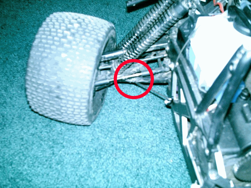

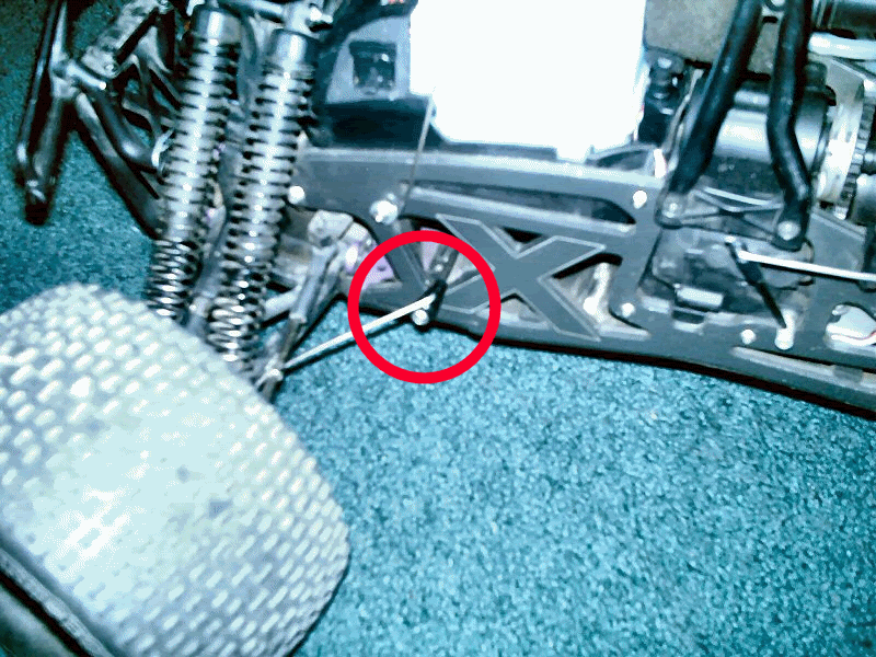

Alrighty, the above images have been resized and touched up abit. I just gotta get a better camera I guess. I snapped a couple of new ones that might give a better visual.
Here you can see the sway bar going into the arm hole
Here you can see the servo horn placement and how the sway bar goes through the TVP.
Hope these help "clear" things up some

Ok, I found the update pictures.
Still not the clearest pics but you can get the idea of where I was going. While they are not "true" sway bars they do have an impact on the handling of the truck and are super cheap. Can't beat free right?
If ya need any of the other pics let me know, I will keep digging. They are bound to turn up sooner or later
It stays in place b/c it doesn't have anywhere to go. Unless you really plow an arm to the point it should have broke, the sway bar stays in where it is supposed to. It can't go backwards since it goes through the servo horns that are mounted to the tvps, and it can't go forward b/c of the suspension arm. And sliding from side to side won't happen either since it is one solid piece from arm to arm.
In the top picture the circle is supposed to show the hole in the suspension arm, slide it through there. Once it is all together they stay in place. The servo horns keep it locked into place.
