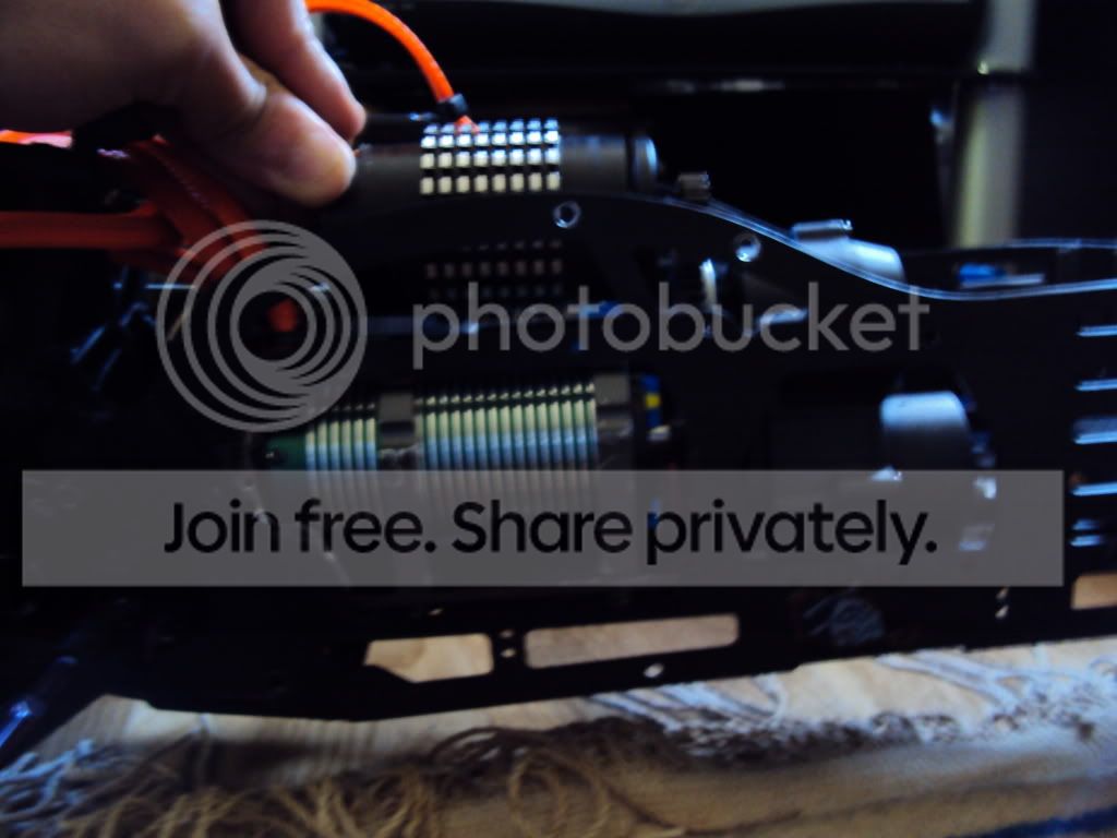

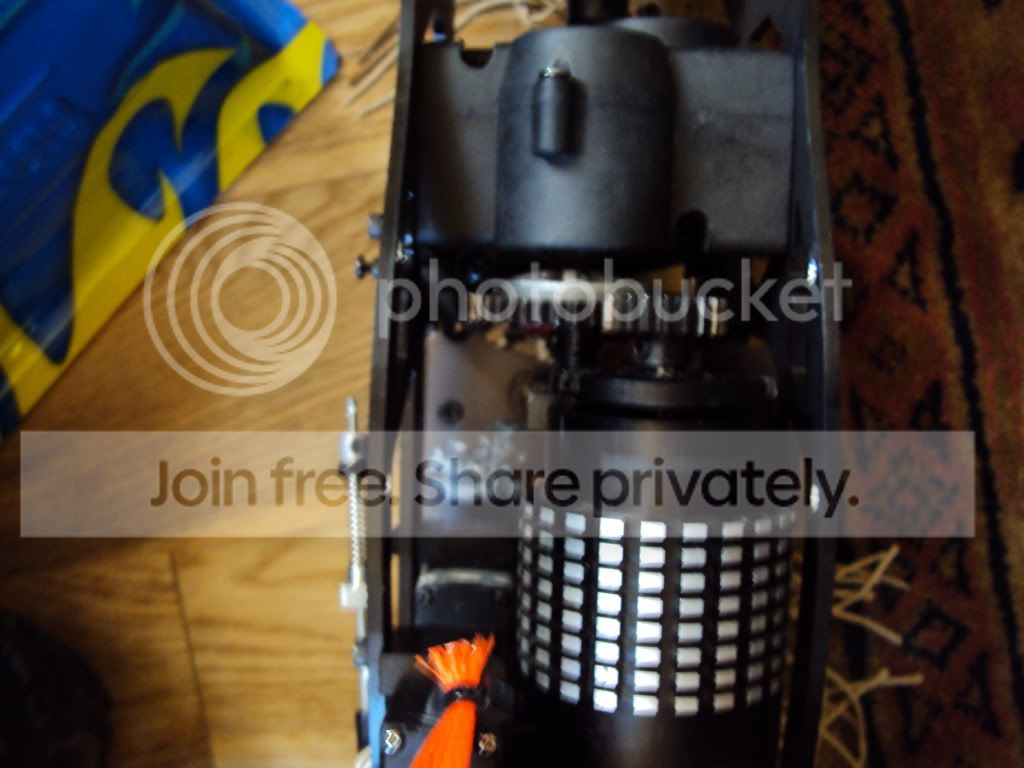

Just got this response from dan
"If I'm not mistaken, the stock E-Savage motor mount will work. The only question will be if the 2 larger diameter motors will interfere with each other, the chassis or the radio box."

i think there could be a concern with two brush less motors sitting that close with the powerful magnetic fields there could be a possibility of interference.
thanks for bringing that to my attention dan!
I have had to change mounting strategies... i Will question dan regarding the interference.... Nice1
here are some pics i sent to dan, so he can get an idea of what needs to be done for the custom mount... I also asked him about possible interference.

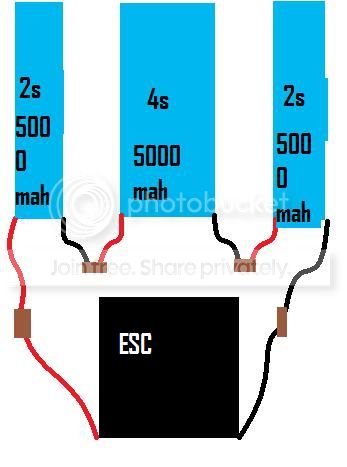

need a little advice and confirmation...
As you know iam going to try an 8s configuration... to keep things balanced, in the truck,
I am going to buy 2x2s and one 4s LiPo. And place the 4s in the centre of the chassis and the 2x2s either side in battery boxes by kershaw.... I will be using bullets and was wondering if it is ok to connect them this way...
Thanks
