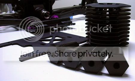

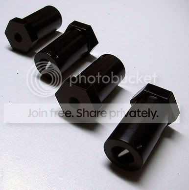

So I'm here looking at the XSS wheels. I don't like 'em. Chrome doesn't suit what I want to go for with this truck. Is there any way to strip the chrome, or should I be looking for another set? Ultimately I'd like to go with some dark wheels, grey or black.
Got some stuff back this week from black ano:
