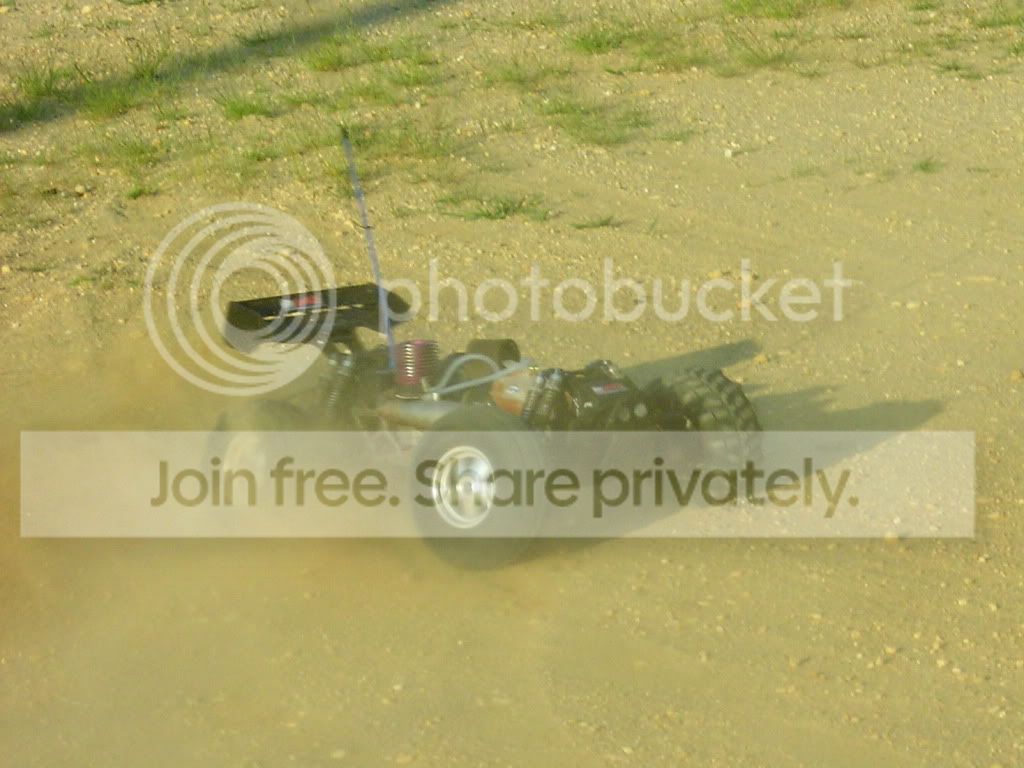

Alex, if you see this post, show him the pic ... worth 1000. plus i like seein yo truck
here you go freddy. This is what a tire looks like as it unloads. This is a bad thing to have happen going around a track.
Exactly and the heavier weight oil you use, the less its gonna 'unload' like that.
a lot of 'savage' racers will use a heavier weight oil up front & lighter in rear so that the front tires will pull the truck through a turn.
