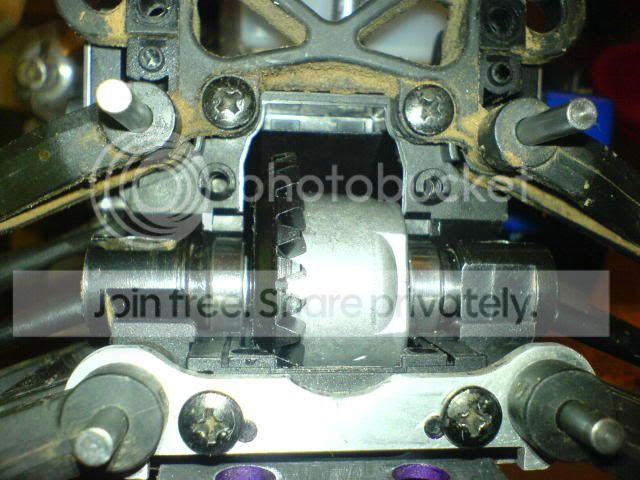

No, the X and Flux bulks both have screw holes in the side to accept the old style bumper mounts.
This is the hole right in the centre of the pic (this is a flux bulk)
Just thought, I'm not sure if you would need to change your arms or not, i don't know if old style arms will fit on X/Flux bulks.

Thanks Max, wasnt sure if old arms would work on newer bulks, do you know if the old round joint posts fit in the X/Flux bulks?
ohhhh gotchya sorrry... i think the bulks come with them pressed in already but I'm not sure.. i know my x bulks are pressed in and came in them.. the older pre x ones slide out .but the bulks are the same width so if need it be I'm thinking the round ones will work .. maybe someones came across the x with no post in them and can tell you if they will work or not .. but I'm thinking they come in them ...
No they don't, its a seperate part #, unless you buy them from an eBay chopshop and they have left them in, if you buy the bulks new not from a chopshop they don't come with them.
I once bought an X bulk from a savage chopshop and it wasnt there and my new Flux bulks which were bought in the HPI pack from a regular online hobby store, both times i had to swap them over from the old bulks, but theyve always been the hex X ones, i have no idea about the round ones, theyre not in the list as fitting the the X/XL Flux etc just the pre X models.
As far as i can tell they wont fit lol the round pre X posts are 4x7x74mm and the new hex X are 4x6x74mm so the 6mm hex hole in the X/Flux style bulk is too small for the 7mm old style round post.
